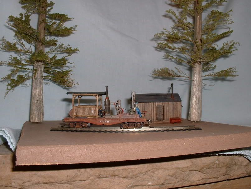

I’ve used both Bragdon and artist pastels from Hobby Lobby and like them both. Here’s 2 examples

this pic made me think of something, is that a moonshine still on that flat car? Made me think I might like to have a moonshine still on the mountain, down by the tracks. Has anybody ever modeled this befor, if so wherd can I get (or make) one. Nice work, Mike
