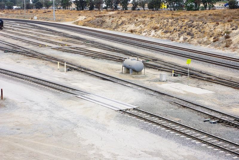

Location and weather conditions play a significant role in the weathering of concrete.

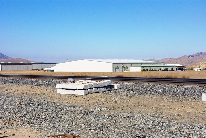

Most of the photos and videos I’ve seen of concrete ties in the western states indicate that they don’t ‘weather’ like wood.
If you look at a concrete sidewalk, for example, they don’t change color very much over the years.
If you Google Amtrak Northeast Corridor tracks you will see pictures of weathered concrete ties mostly just rust streaks around the tracks and tie plates.
Concrete ties don’t weather much. A light gray shade is fine. The color of the molded plastic ties on Atlas concrete tie flex track isn’t bad.
