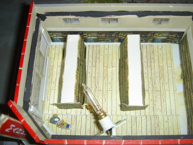

Building interiors are a subject near and dear to my heart. On my layout, many structures are right in front. I’ve sought out buildings with large windows so that the interior detailing can be seen. This is one of my favorites, the City Classics “West End Market.” It’s a simple kit with a design which would be at home in many layouts.
A look inside reveals the simplicity of the detailing. The floor, walls and even the grocery shelves were all downloaded from the Web, sized appropriatetly and printed on card stock on my computer. I added a simple lamp and a few Preiser figures:
I’ve also done some interior detailing on buildings with small, multi-pane windows. After putting in walls, furniture, figures and lighting, I discovered that it was almost impossible to see any of the details. So, be aware that this kind of effort may not be warranted unless the windows are big enough to see through.
