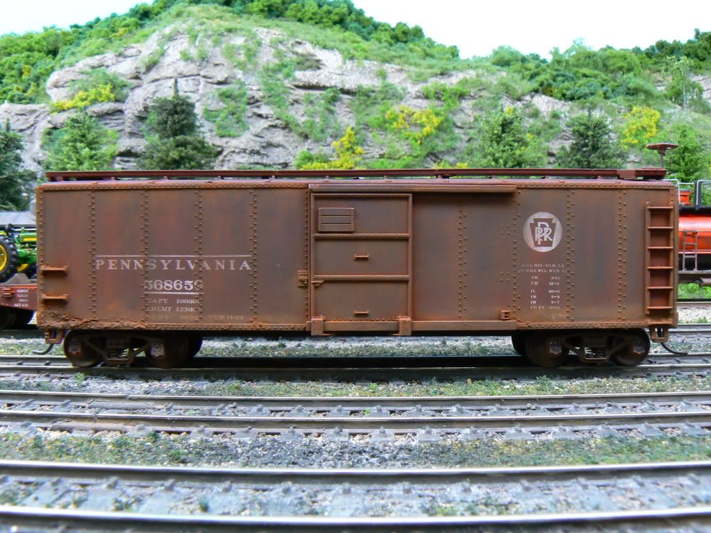

Thanks, Todd…you made my day! [:)]
-Crandell

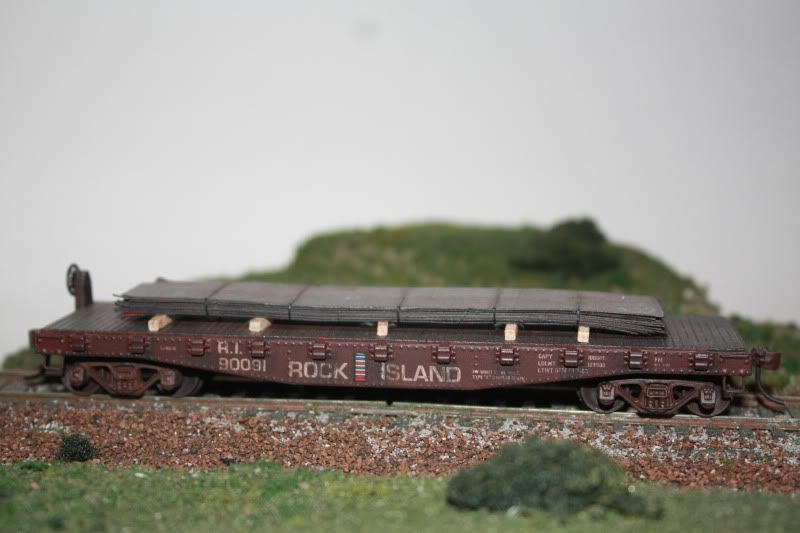

That is incredibly awesome! I am just amazed at how well you’ve captured the sense of rust on the boxcar.
John
What did you make the load out of? Aluminum foil?
john
