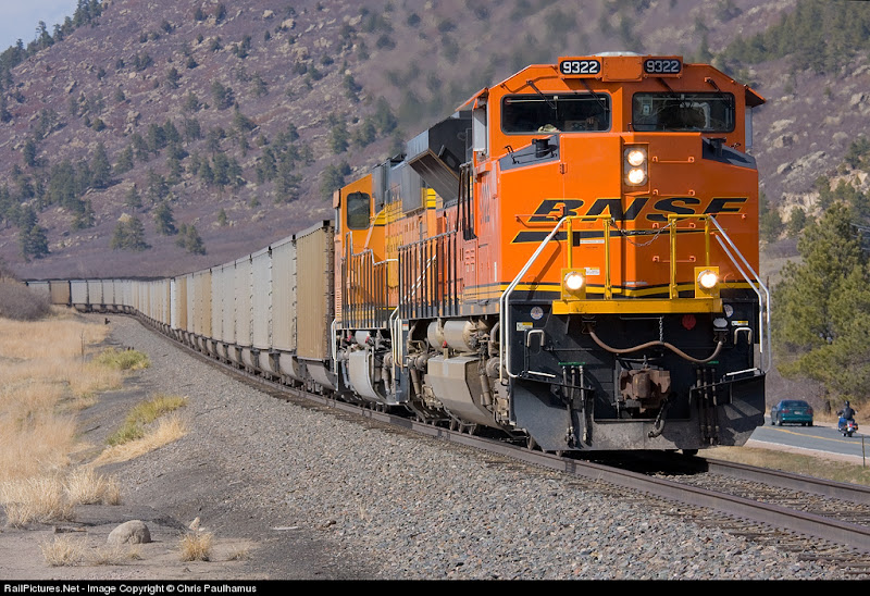

Talking about rusty rails.
I look at a lot of pictures on railpictures.net and they seem to have rust on the rails and about 6" to a foot on each side of the rail and a black swath down the center section of the ties. This makes me think that a brush down each side of the rail and and onto the tie would be the way to go. Ballast and ties both are rusty outboard of the rail. I have just started thinking about painting my rails so this post has piqued my interest.
Have fun. [:D]
Lee
I don’t know about you guys, but in my area I don’t see a lot of rust on the rails, more of a black/brown. And the ballast looks clean in the middle on the mainlines. But maybe a yard or industry tracks.
I see what you mean. Although that does look like a dry area and the ballast looks newer.
Location must play a big part on how the track weathers.
Good day [:)]
Lee
