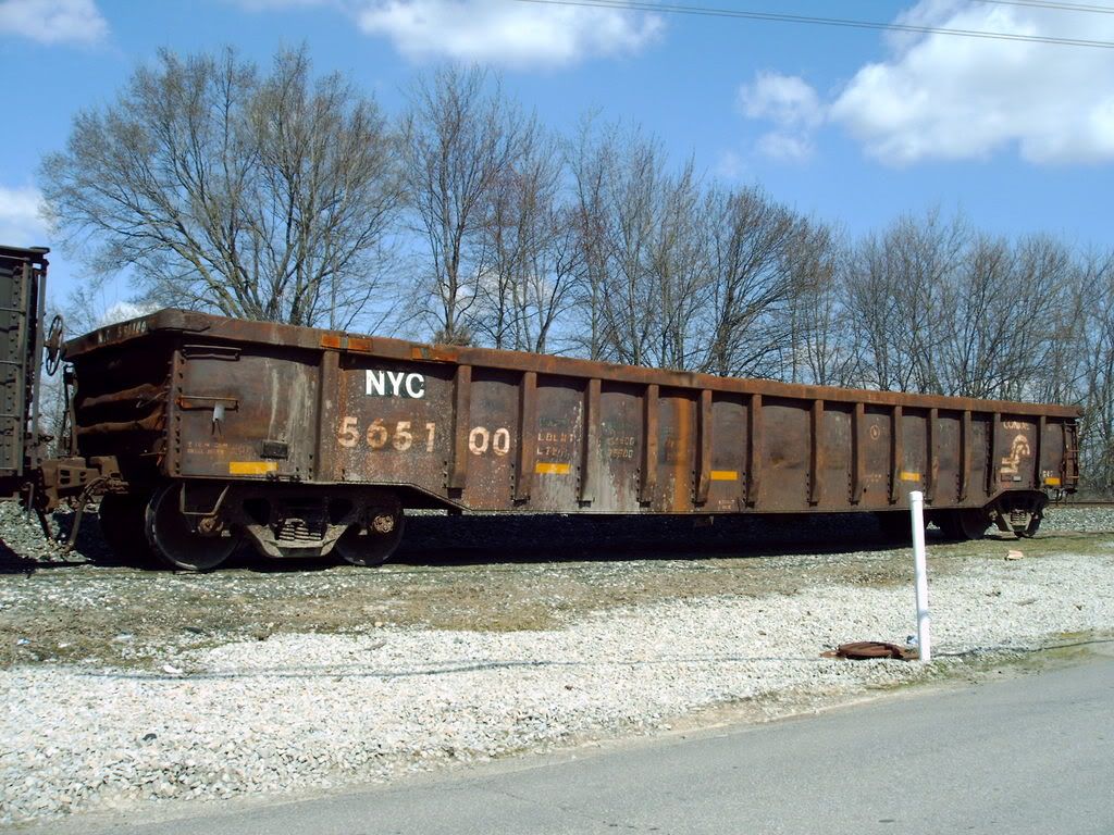

It just so happens that today I came across and old beat up gon and thought of this thread. I had my camera, so I took some reference shots. Take note of some of the damage, and repairs, to this old gon.
Notice the tears and hasty patches on the top left…
Notice the side rib damage close to the camera…
Lastly, notice that it’s slightly swaybacked…
This gon is in current use on CSX’s mainline just outside Indianapolis, Indiana.
