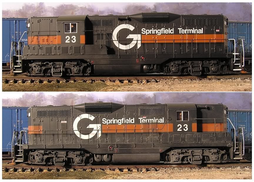

I’m a custom painter and of course use my airbrush a lot, however I don’t use it that much for weathering. Much of my weathering is done with just washes and weathering powders, (you can use chalks, but you’ll get better results with the powders). For many of the effects where you would use an airbrush, you can get similar and sometimes better results with chalks and/or powders, washes and straight paint. No airbrush was used in the following examples:
As others have mentioned airbrushes have their place but over the years I’ve started to lean more towards washes as the more effective technique. When starting out I’d suggest using oils and limiting yourself to only two colors: burnt umber and perhaps a touch of black. Lighter color pieces of rolling stock are easier to learn on than darker ones. The top of silver box car roof would be a good starting point.
If you go to the progress photos of my site here:
http://www.lancemindheim.com/2009_archives.htm
and scroll to November 2 you’ll see a loco. weathering project using just those two colors.
Lance
