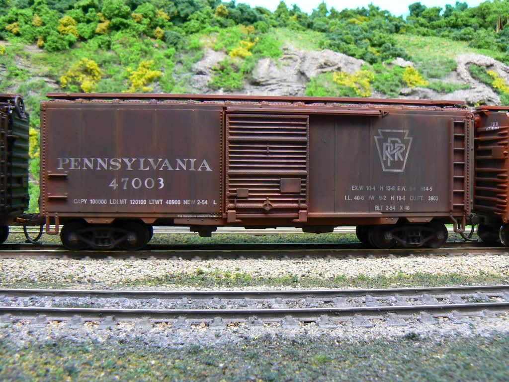

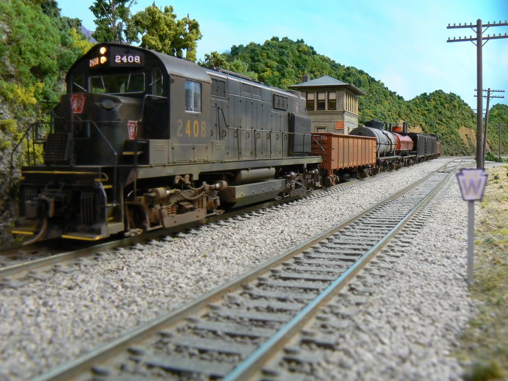

Hi: I’m certainly no expert, and as these were my first attempts, I’m happy with them. I used Bar Mills weathering powder. Since Crandell covered steam pretty well, I’ll take a crack at diesels and freight cars.

Alco RS-27

40 ft box car
This is a model?!
Here you see my How To.
