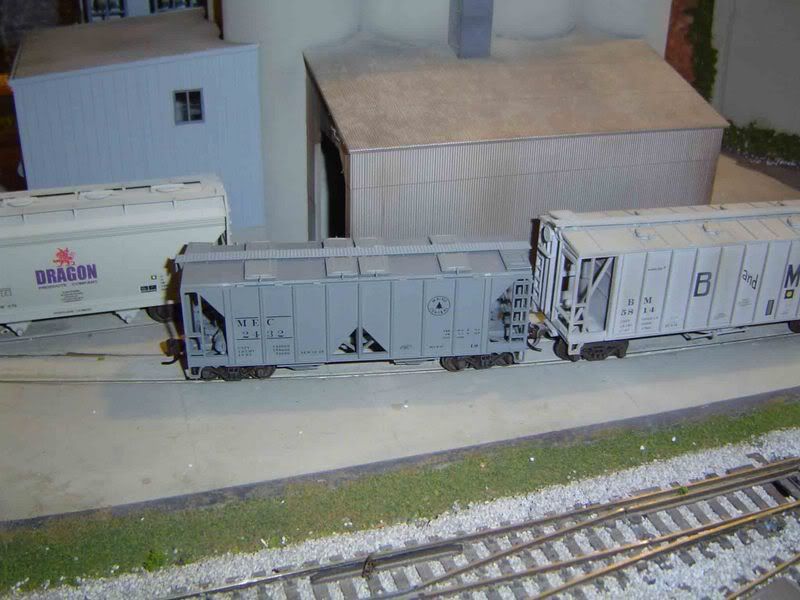

For my home layout, I just completed assembly of a Bowser covered hopper, MEC2432 the dark gray one. I still need to do some weathering and concrete spillage. It is shown at the Dragon Cement bulk and batch plant on the storage track awaiting unloading.

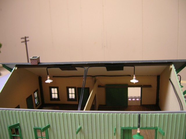

I spent two solid evenings figuring out how, drilling and wiring my Alexander Scale Model NYC Freight station with interior and exterior lighting:
Click picture(s) to enlarge
The first two pictures were taken in the early morning hours. The third picture sorta shows how I wired the 2 exterior trackside lights and the interior ceiling lights.
The wires are tunneled through painted brass tubing (You can see one just left of and at the rear of the divided wall of picture 3, in the corner) to look like interior venting stacks. This will give the interior of the depot a more finished look through the sliding doors and make replacing the light bulbs easier.
For both the interior and exterior lighting, I decided to use 1.7mm 12V incandescent bulbs because they lasted longer (5,000 hrs.) and fit the painted lamp covers better. (No glue needed! [:)]) I have them hooked up to a spare MRC Rail Command power pack set at ~9V. That should make them last even longer.

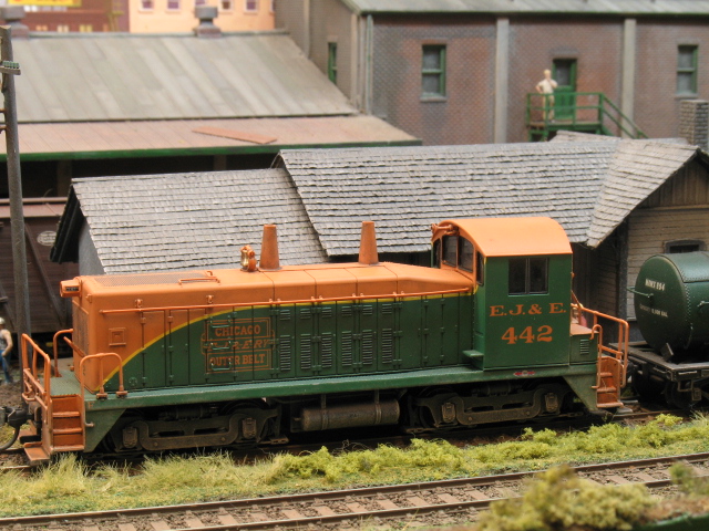

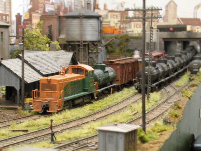

I’ve been messing with my new EJ&E switcher from BLI.

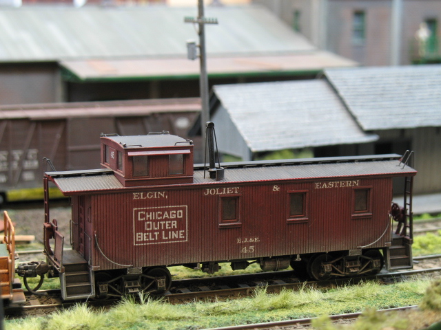

I also lettered up a caboose for it
And shot some video
