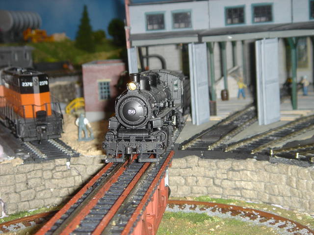

I’ve been working on the Pit-Bash, converting an Atlas deck turntable to True Pit. This weekend, I put down some Gypsolite over the pink foam. It’s still in its “raw” state with only a little color from the cheap acrylic paint I squirted into the wet plaster, but it was good enough for a couple of photos. This is a shot of Number 56 pulling out of the roundhouse:
I also (accidentally) took a flash picture. Normally, I don’t care for the results when I use a flash, but this one came out pretty well. For one thing, it lit up the interior of the roundhouse. I do have lights in there, but right now I’m still doing scenery so I didn’t have the wiring connected for either the stall tracks or the inside lights.
The rock pit wall is a hydrocal casting. I used Dave Frary’s “Weathered Wall” mold from www.mrscenery.com. After the hydrocal set for about 10 minutes, I bent it around a curved form so it took on the radius of the pit wall. This conversion uses a false floor to the pit, which is attached to the outer rim of the Atlas turntable. That way, the floor doesn’t turn with the bridge, and I’ve got something else to attach the pit wall too.

Those castings really came out great. Did you have any trouble with fitting/ interlocking the sections? Looks like you hid the seams quite well.

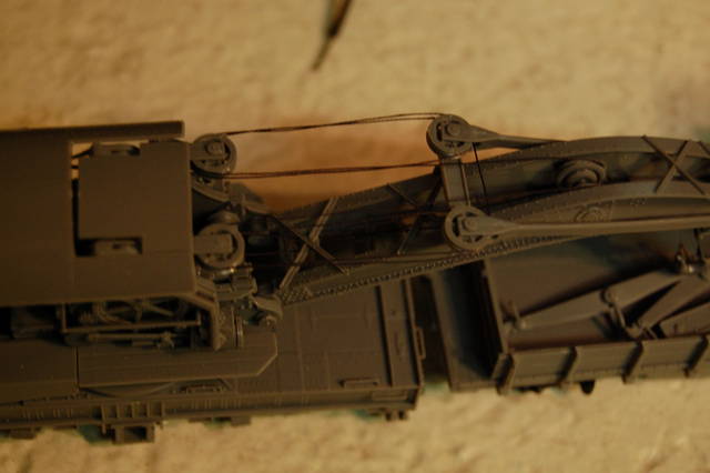

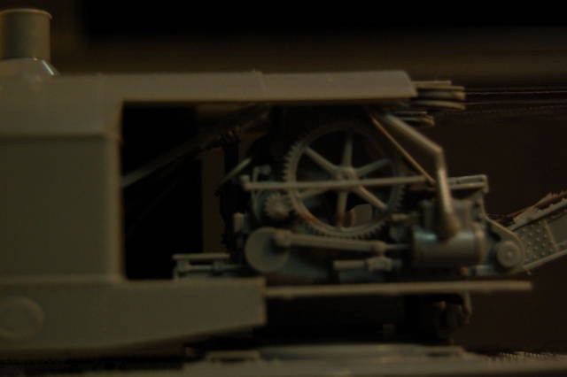

Finished working on the crane/boom car from Tichy that I got a while ago. still needs paint, decals, couplers, and maybe a touch of weathering to finish it off though.
the pics are a bit underexposed and maybe a touch on the blurry side, but I think that they came out fairly well for a quick shot.

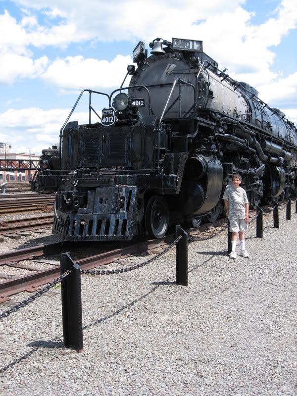

Got a new digital camera & did some railfanning at Steamtown, Scranton, PA

You got me on that one. The camera position and the turntable bridge were carefully placed to hide the seams. At this point, I’ve got a couple of gaps that need to be patched up a bit and hidden with some greenery. I actually had the wall pretty much gap-free, but when I ran the bridge around I had some “clearance issues” and when I pushed the walls back a bit the gaps appeared.
The casting segments are about 6 inches long. Since the casting is more than twice the height of the pit wall, each casting made two segments. I tried to place the gaps beneath the stall rails so they wouldn’t be as obvious.
