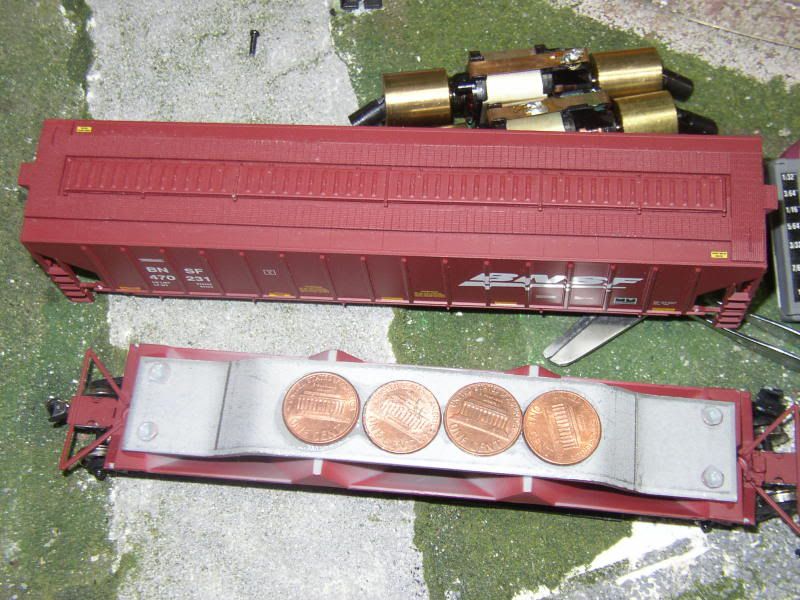

I had no problem getting my Athearn covered hoppers apart. I just inserted a flat tip jewelers screwdriver between the upper and lower sections of the body near the ends and gently pried them apart. The car in the photo was very close to the NMRA specs but I wanted it spot on. Four pennies did the trick.

Where exactly did you put the weight in the Bombardier cars?
I have a bunch but haven’t really run them yet.
It’s good to know the solution before I even discover the problem!
Thanks,
Craig
jw:
Hey, they’re not pennies! They’re “Lincoln weights”. I think they’re great, and often use them in conjunction with cellulosic molecular bonding strip (available for $2 in the paint-sundry aisle).

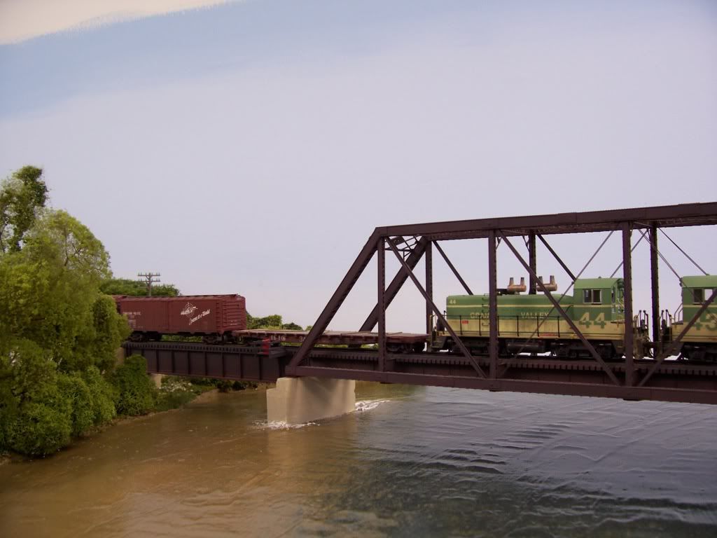

Wayne,
Absolutely Beautiful work on the water in that river, Great Job [bow].
Doug
Thanks for the kind words, Doug. There are a few more pictures HERE , and a lot more in the same sub-forum.
