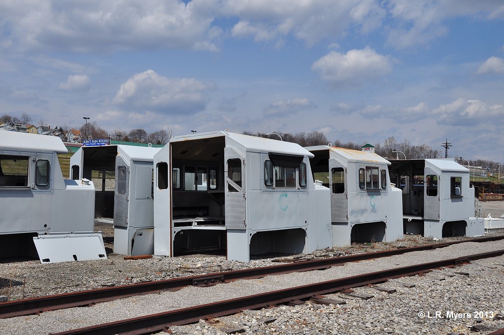

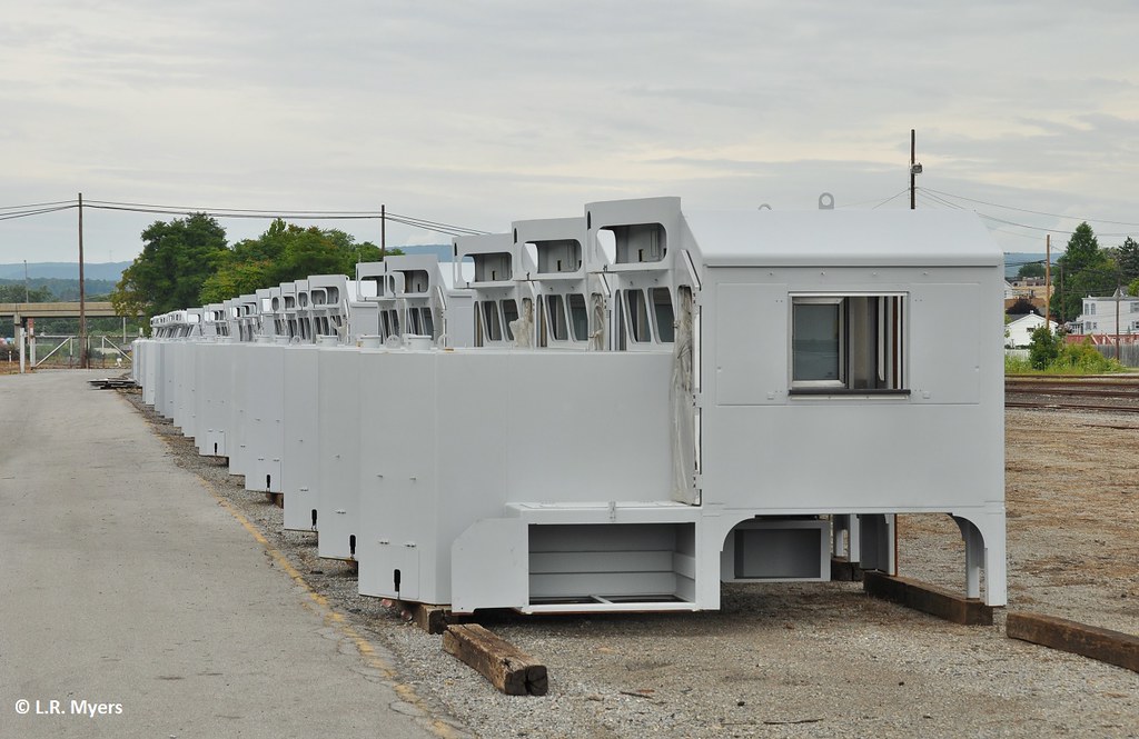

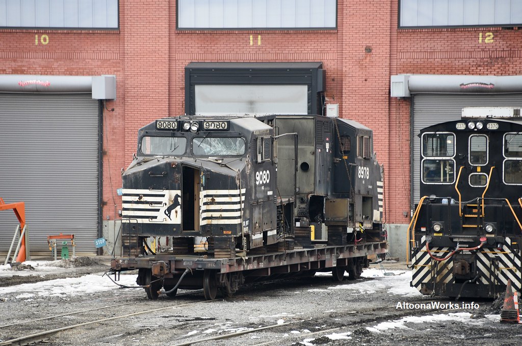

There’s a fellow I follow at Flickr that posts quite a few photos of goings-on at the NS Juniata shops. A few years ago there was quite a bit of activity including upgrading to ‘Admiral Cabs’ and Crescent cabs. Better crashworthiness was one of the goals as I understand.
130410_18_juniata by akmyers83, on Flickr
190227_1_juniata by akmyers83, on Flickr
140811_33_hollidaysburg by akmyers83, on Flickr
More here:
https://www.altoonaworks.info/rebuilds/admiralcab.html
