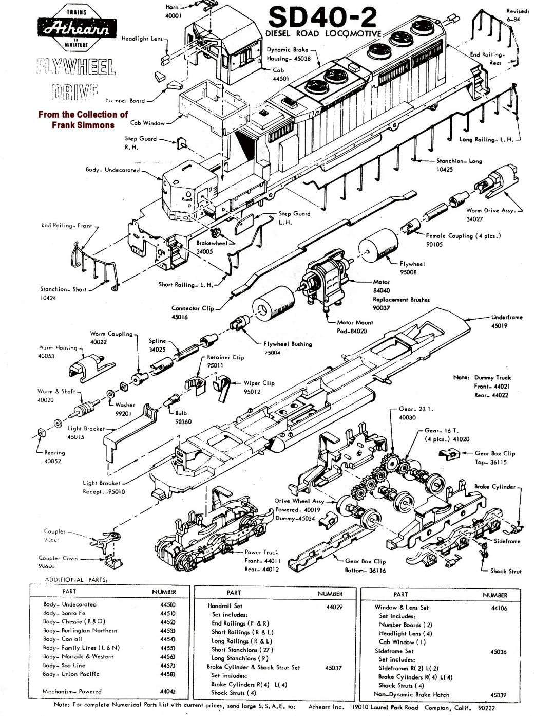

I am all set to start powering a dummy SD40-2. I thought I had a donor chassis/motor/trucks, only to discover that the trucks and drive shafts are wrong and won’t work in this application. I think the donor was an SD-7 or SD-9 after a bit of research. I checked HOSEEKER (http://www.hoseeker.net/assemblyexplosionAthearn/Assembly%20Explosion%20Athearn%20SD40-2.jpg) and the trucks are part #s 44011 and 44012 and they are no longer offered from Athearn. I will begin scouring eBay for the trucks/shafts/couplings, so I figured I would stop here and pose the question first. Are there other models that share the same drivetrain? - mainly the trucks, but if I can find another donor chassis all the better. HOSEEKER doesn’t have parts diagrams for any SD’s aside from the SD9, 45 and 70. The SD45 shows a different part number, as does the SD9 (which I believe I have)which looks similar, but doesn’t sit in the frame correctly - the pivot point is at a different level.

Thanks. I will be looking for another SD40-2, but I figured there may be other options so I thought I’d check it out. I checked the HOSEEKER for the C44-9w and AC4400, and they both use parts# 49440 & 49450 for trucks - a different part # than the SD40-2. You mentioned these as compatible with the SD40, was the -2 put together differently?
