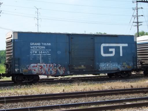

Not something unlike these cars, right? I often see them on autorack trains being used to separate cuts of racks.
Chris, picture something that high, but shorter in length (that GTW car is a 50-footer, I think), and something that wasn’t rebuilt from a car less tall.
