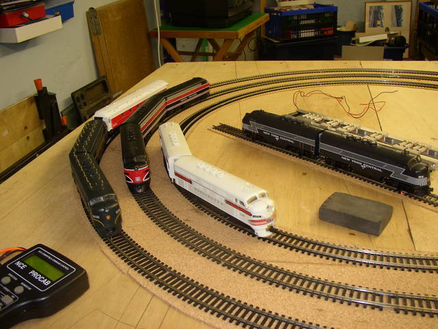

a 4’ x 4’ layout that has continuous running in HO pretty much limits you to this sort of thing.
Test track for DCC and DC
