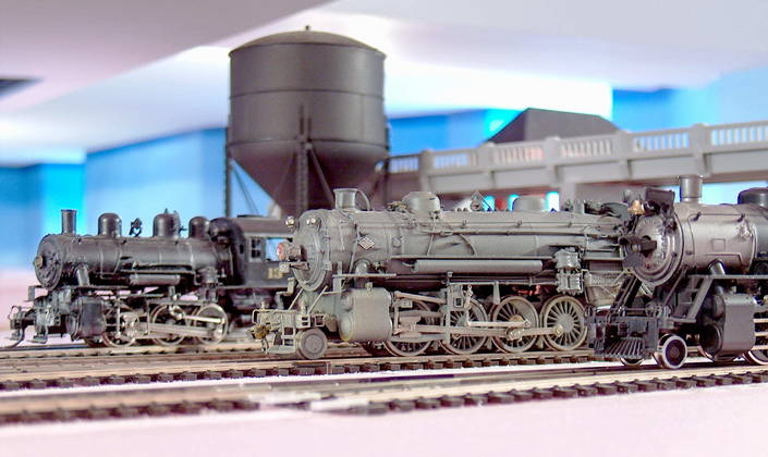

Wow, things get intense in a hurry. I personally like the way Aggro Jones’s Challenger looks,maybe a touch too light for ME,but nice looking.Personally, I go for a happy medium between correct and asthetically pleasing to me.If you where going for a grayish loco, would t Floquil’s weathered black be a good choice? Im compilling and comparing weathering styles before I throw some paint on my new Big Boy. There seems to be alot of different techniques.[swg]
The wide variety of “blacks” is testiment to the different tastes of modellers.
In Floquil alone there is weathered black, steam power black, oily black,engine black,grimy black,and…black.

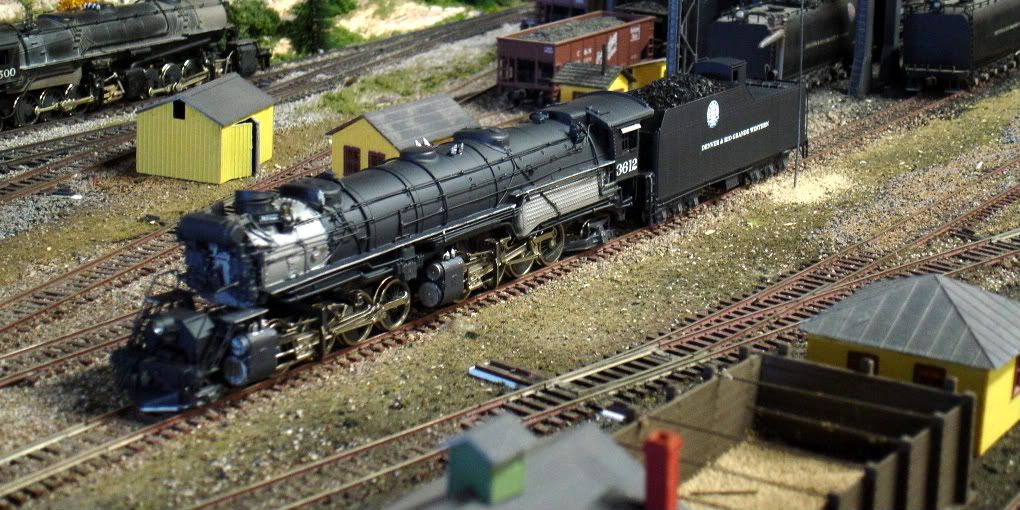

I use Floquil grimy black and weathered black when I paint my brass locos. It’s “Black”, but you can still see the details under my model rr lighting. I’m not a great fan of ‘weathering’ my locos, so when I do, I do it lightly, as if my MR was a ‘good housekeeper’, and then I use the Bragdon self-adhesive weathering chalks. My particular steamers have a paint scheme of graphite smokeboxes and fireboxes, which I use by mixing Floquil dark graphite and Old Silver, about 70-30. Cylinder heads and trim are ATSF silver. It’s fairly close to the colors of my prototype railroad (Rio Grande).
Here’s a 2-8-8-2 fresh out of the paint shop. Haven’t weathered it yet. Frankly, I’m undecided if I want to, but if I do, it will be with ‘soot’ and some ‘dirt’ around the cylinders and drive wheels and trucks.
