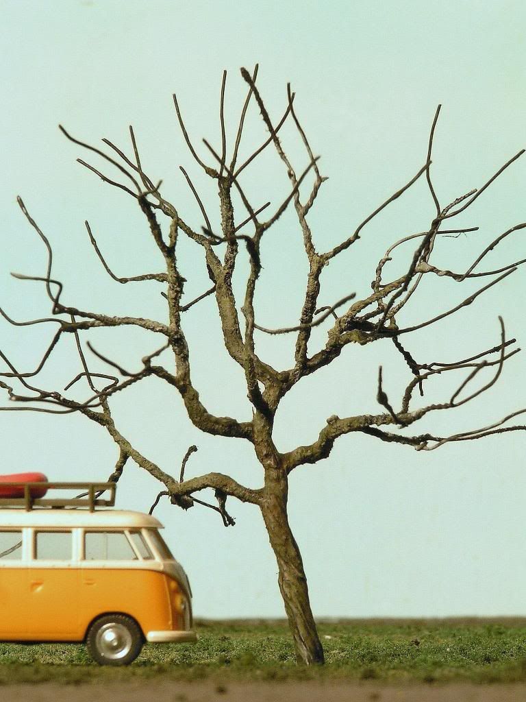

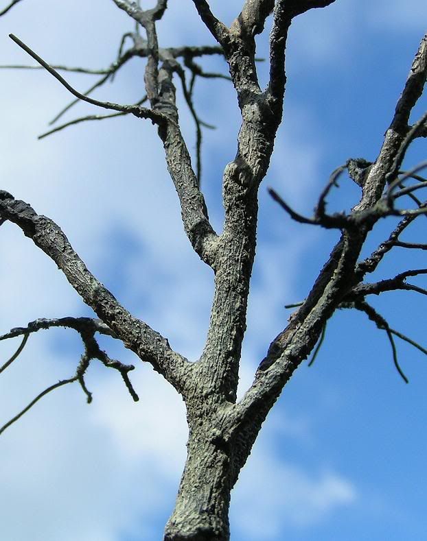

grey trunks
greytrunk
grey trunk

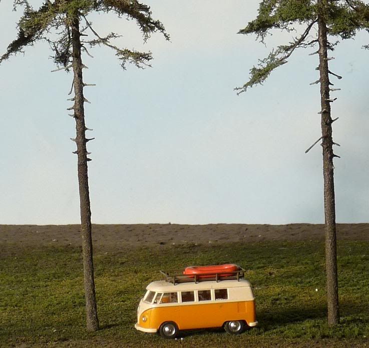

I’d forgotten I’d posted about this.
The last picture here, that is “tree” color to me. I think we were mainly maples and oaks or something. Rather generic “tree.” I wouldn’t have thought to try non-black or white paints to mix for a gray, even though I know from color selection in graphic design software that any color isn’t very far from gray.
