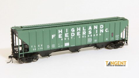

Evans 4780 from Walthers
PS 4740s from Tangent.
Many (most?) of the Pullman cars I’ve seen in the green or red schemes have black underbodies and ends, but the prototype Fremont Elevator car looks to be the same color overall. However, many of the blue cars were from other builders like Evans or FMC, and it seems to me many of those were later. Greens varied from the more subdued color on the Tangent model above to a brighter BN-type color.
