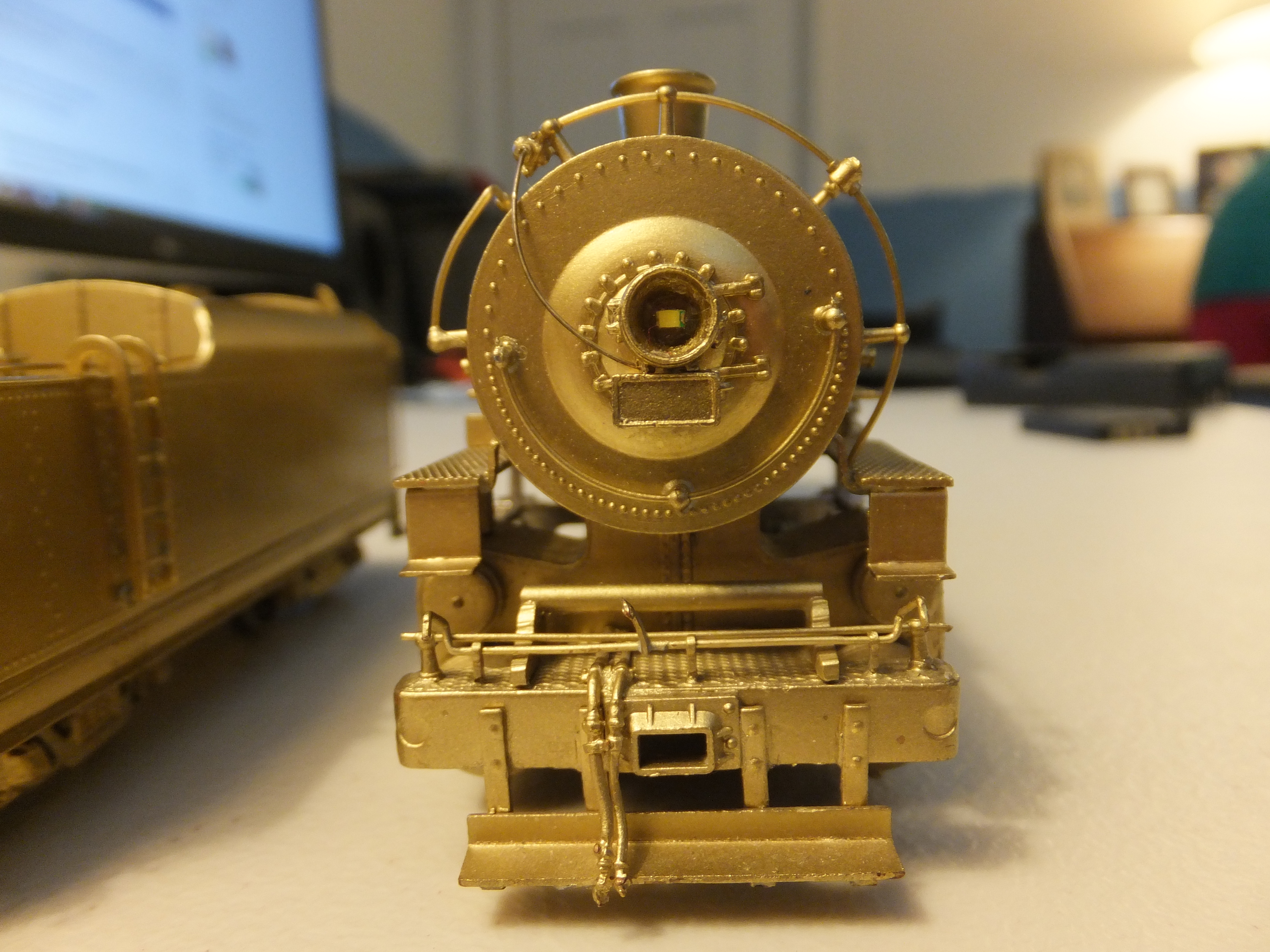

The SMD LEDs I usually reserve for my brass locomotive installations because the “bulb” is much more visible inside the headlamp. This what a 0603 warm LED looks like in a NJCB 0-10-0 switcher:

Dave’s post is spot-on. I used 10K resistors on my brass locomotives that were mounted with 0603 LEDs. The light from them is softer than how my above photo portrays them.
