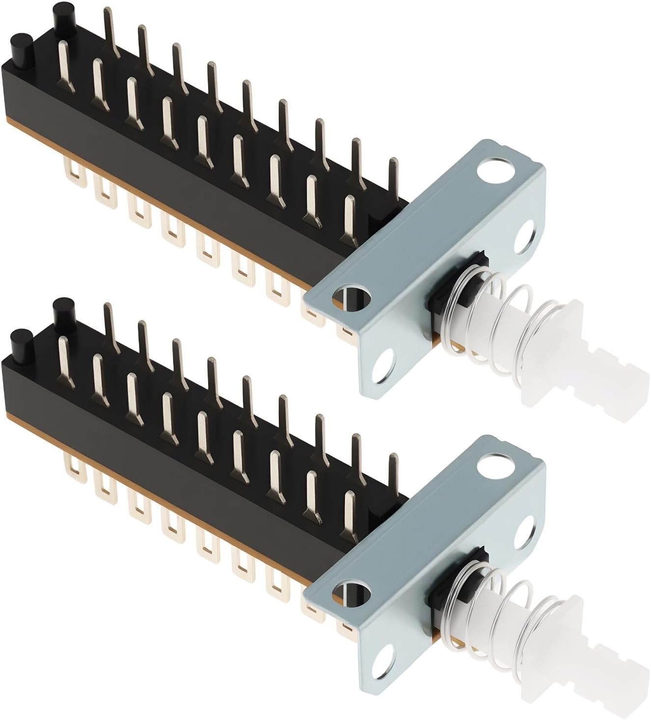

I think it probably easiest to wire a second one into the system by adding a 6p2t switch like this
Directly inline by splicing into the line between both modules and splicing a second feed from the wall wart power supply to the new pannel. Or would you suggest a second power supply or some other system of isolation
what NCE system do you have?
track is just 2 conductors. why a 6 pole switch?
I have the starter system. I was thinking the 6 lines for the data cable to isolate panel controlling the programming track from the layout during programming. That way the usb interphase can be left connected down stream from the first power panel thats on the layout.
