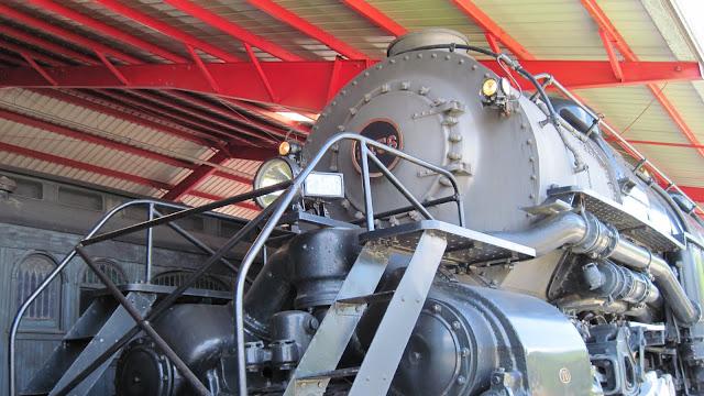

St Louis Y6A [:)]
Museum pics here
Thanks for posting ths shots Geared Steam! Looks like it’s mostly under cover and well maintained. who knows, maybe someday…
Your welcome Firelock
Many engines are under cover, many are not. They are continually trying to raise funds to cover the entire collection. The problem is they are so close together its difficult to get “great” pics, but that’s the price we have to pay to keep those beauties out of the weather.
Like Steamtown, the Horseshoe Loop, and the California RR Museum, It is a “must see” for any railfan, I have many more pics on my blog link, and I didn’t capture everything they had. (GG-1, trolleys. 4-4-0’s, etc)

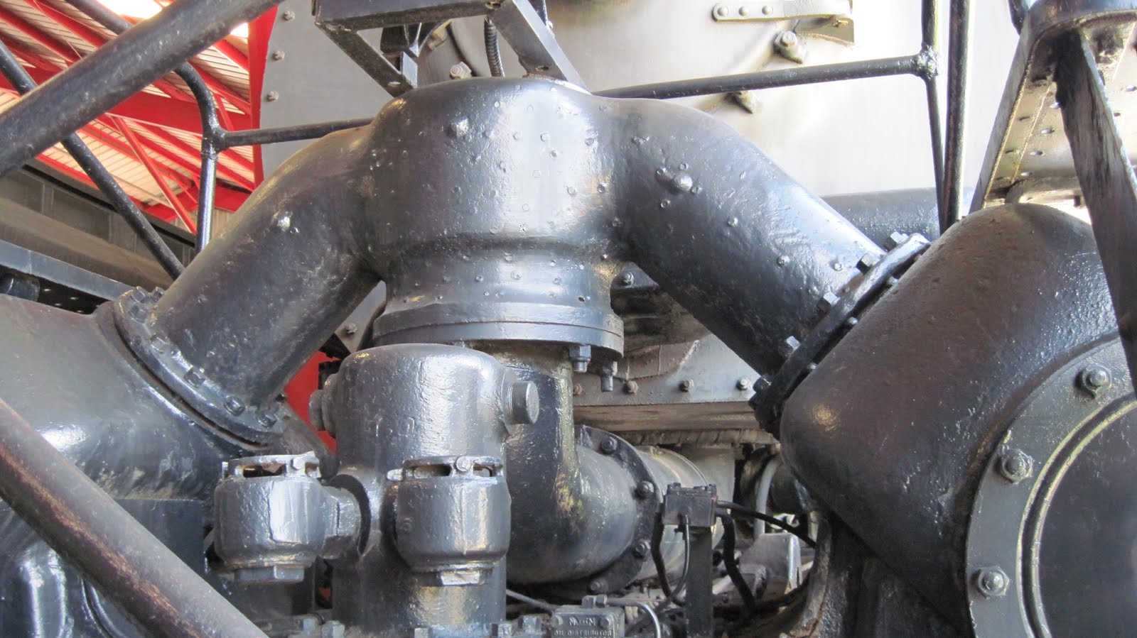

I love this shot of the Y6A, imagine the power being funneled through this piping?
