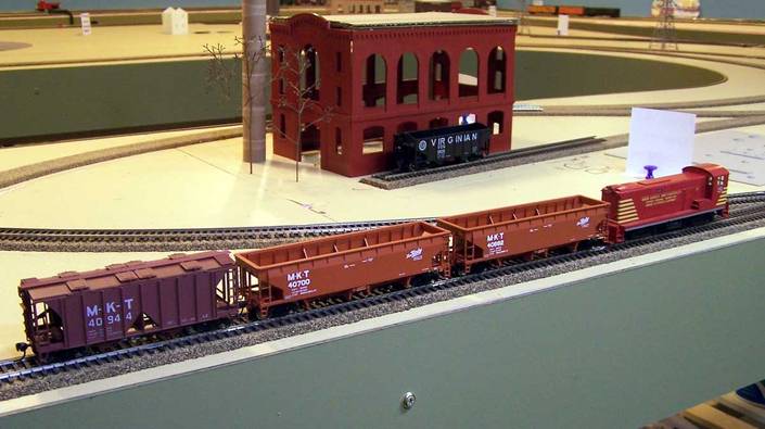

Atlas recently released in HO. Here are two of them for the Katy.
