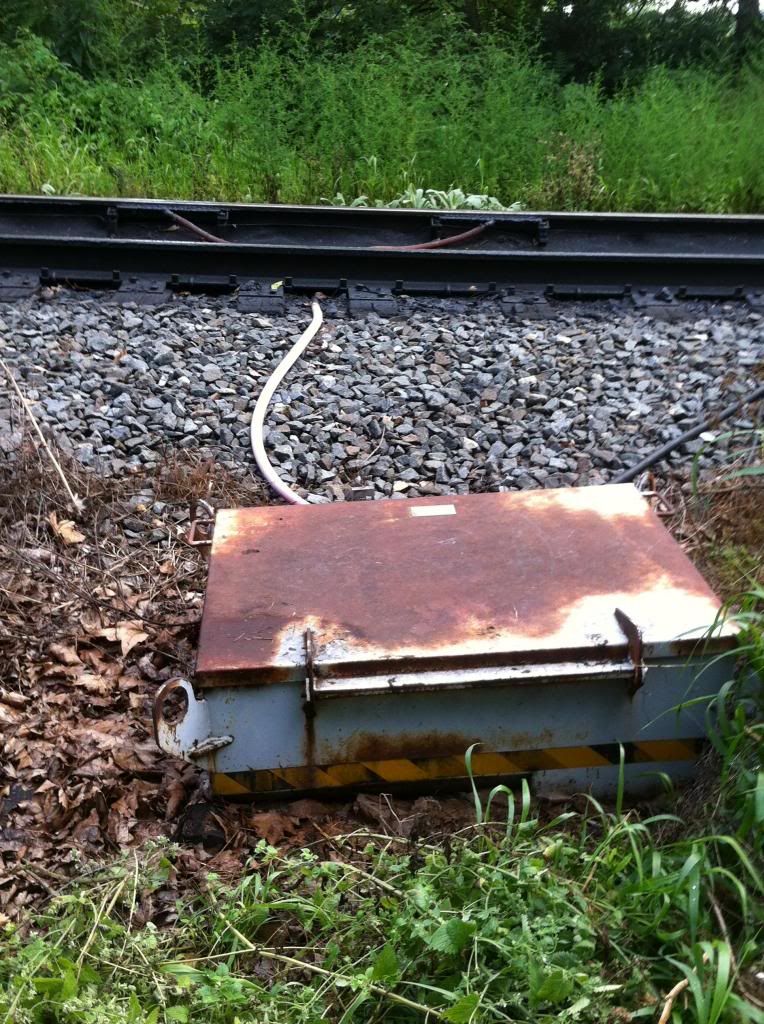

What is this trackside device?
I was walking along a local walking path and saw this device on the tracks that runs along the path. The line is essentially an industrial spur and serves several local industries over the 10 mile or so long line. As you can see in the picture there is a metal box next to the tracks with some tubing running to one of the rails. It appears very greasy but I can’t tell if it is emitting the grease or is just kept greasy as part of its operation. What you might not be able to see is in between the tracks is what appears to be a large black, rubber mat, probably to soak up the grease. Does anyone know what this is used for?
Flange lubricator.
As Norm in the previous post identified the object, you may wish to read more about these items here. Additional images of these lubricators can also be found here.

This particular spot is at a switch to a couple industries. The turn into the industry, while I couldn’t see the whole thing from the path I was on, seemed pretty sharp. So it makes sense to have it positioned there, to me.
They have been manufactured in Owego, NY for over 70 years and are being made by other companies around the country and the world today. Trains Magazine did an article on them within the last year.

The correct term for the rail appliance is flange lubricator, and if the flanges are all that they get, they can be a good thing. But I guess it can migrate to the top of the rail, too.

Lion: The lubricant carries quite a ways. Often one flange lubricator will protect multiple curves. If the tonnage/ wheel count is similar in both directions, the flange lubricator may well apply the grease in tangents in the middle. Sometimes the blades are on the gage side of both rails and sometimes just one side with overlapping coverage.
Many times, the grease is applied by the locomotive or hi-rail truck. (Not so much on locomotives - the mechanical bubbas don’t like the extra duties making sure the grease supply is full…the RFE and the TM probably bribe the mechanical folks to not refill them.)
I see Bob found one of those Portec solar powered spoogers. The acrimony between trainmasters and roadmasters over application of grease is legendary.
In mountain country, often one man is assigned solely to maintain, refill and adjust the flange lubricators.

Probably wouldn’t have helped. Perhaps somewhat surprisingly, the squealing is often not from the flanges rubbing against the gage side of the rail head. Instead, the screeching is from the tread of one wheel ‘hopping’ or ‘skipping’ a microscopic distance - called “creep” - due to the wheels being mounted rigidly on the axle, and the different distances around the curve of the inner vs. outer rails. That distance differential has to be made up somehow, and that’s often how the wheel-axle-rail-track system accomplishes it.
