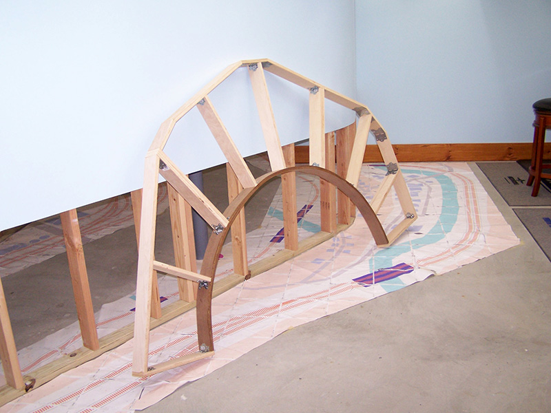

I have assembled items in the past with blocking as you describe. It does create a strong join. However, it has a shortcoming that impacted my benchwork - facilitating shallow angles. The image below demonstrates one such situation. Blocks would have been space consuming and difficult to reliably cut at the correct angles for the outer perimeter of this section. Especially where short perimeter pieces meet crossmembers. It also would have been challenging to cut the concave shape into blocks for correct fitment to the curved spline whereas nailing angles are drawn to the correct curve during tightening.
The ability to easily remove and reinstall crossmembers is a valuable feature of both nailing angle and block construction. It has made my life easier on several occasions already.
If my benchwork were 90 and 45 degree angle joins then I wholeheartedly agree with you - blocking is ideal. When a large number of odd angles, especially greater than 90 degree, are utilized then nailing angles edge out blocks.
