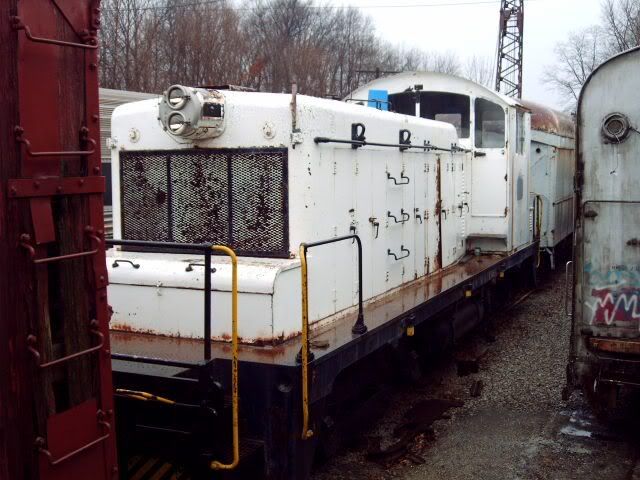

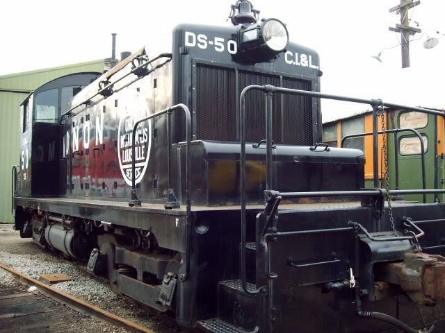

We do have two F9A’s,
http://i83.photobucket.com/albums/j319/pcarrell/Prototype%20Train%20Photos/aan.jpg
http://i83.photobucket.com/albums/j319/pcarrell/Prototype%20Train%20Photos/abs.jpg
2 B units,
http://i83.photobucket.com/albums/j319/pcarrell/Prototype%20Train%20Photos/abr.jpg
a VO1000,
http://i83.photobucket.com/albums/j319/pcarrell/Prototype%20Train%20Photos/VO%201000/aep.jpg
a GP7 & a GP9,
http://i83.photobucket.com/albums/j319/pcarrell/Prototype%20Train%20Photos/Captured2007-7-2100010.jpg
http://i83.photobucket.com/albums/j319/pcarrell/Prototype%20Train%20Photos/Captured2006-8-1200018.jpg
a 44 tonner,
http://i83.photobucket.com/albums/j319/pcarrell/Prototype%20Train%20Photos/aea.jpg
a couple of other old switchers,
http://i83.photobucket.com/albums/j319/pcarrell/Prototype%20Train%20Photos/aam.jpg
