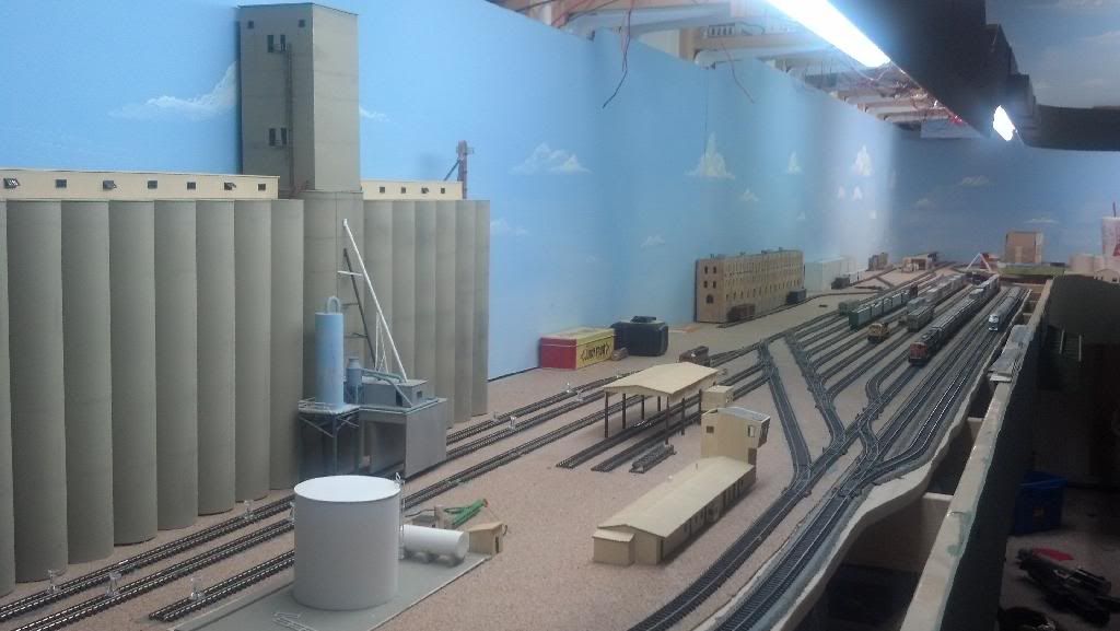

I have tried both designs in efforts to model the same yard. What I have settled on is a combination design with double ended arrival/departure (2) and runaround tracks but stub ended classification tracks. When I had a completely double ended yard I discovered that the second ladder seriously limited the length of my classification tracks, even with a diamond shaped design, and that I did almost all of my switching work from one end even with the second ladder. Having the double ended A/D tracks allows trains to arrive/depart in both directions and the stub ended classification tracks give me the additional track length I needed. Below is a photo of the yard as it stands now in this configuration.
I hope this is helpful.
Ron
I just realized that my design is similar to the one in the link provided by NP01 above. It has a visual schematic of the similar design.
