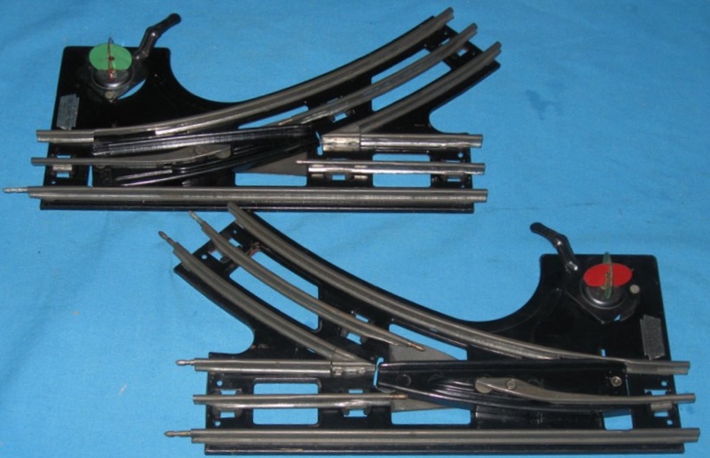

I use prewar Lionel O-21 green manual turnouts and a 45 degree crossover. Since I’m also running Standard Gauge the prewar look appeals to me.
My O layout is Atlas, but I have a stockpile of tubular and a couple train boards stashed in the shed for Christmas displays that use tubular. I use tubular for my Standard Gauge. We used Peco On30 for the narrow gauge portion of the layout and Bachmann EZ-track when we put the On30 under the Christmas tree (no switches, however).
Those MARX switches look just fine. I also use O27 track because that is what I had.

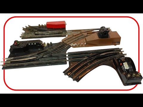

Speaking of Prewar & O-27 Tubular track, I like the Lionel 1024 switch turnout. Super easy to use, super reliable & now-a-days they are cheap and easier to find than before. My QUESTION is this: Will Lionel O-21 Prewar/Early Postwar switches work equally well with both American Flyer O-Gauge AND Marx “fat-wheel” locomotives? THANKS!
[quote=“fwright, post:18, topic:409180, full:true”]
I also use the Marx turnouts because they are the only 027 turnouts that will let my Marx engines (and any other 027 rolling stock) through.[/quote]
Lionel 1121 & 1024 have that same attribute.
@PrewarAmericanFlyer here is a good video describing different turnouts
Thank you. Mike over at TTT&T does a good, solid job. I’ve been following his videos for about 5 years, and I was one of the early subscribers to his excellent channel. He actually has a small(er), budget focused, O-27 layout but his videos and channel hit well above the layout’s “weight class” :slight_smile: He has grown his channel into one of the largest in the niche North American O-Gauge video audience on YouTube :slight_smile: I salute Mike and all the hard work he has done to evolve his channel over the years giving us excellent info. BTW, I am running a LOT of Prewar trains so I need turnouts/switches than can handle all the Prewar and early Postwar locomotives without issues. Much of the Postwar and Modern-era production just can not deliver in that area.
