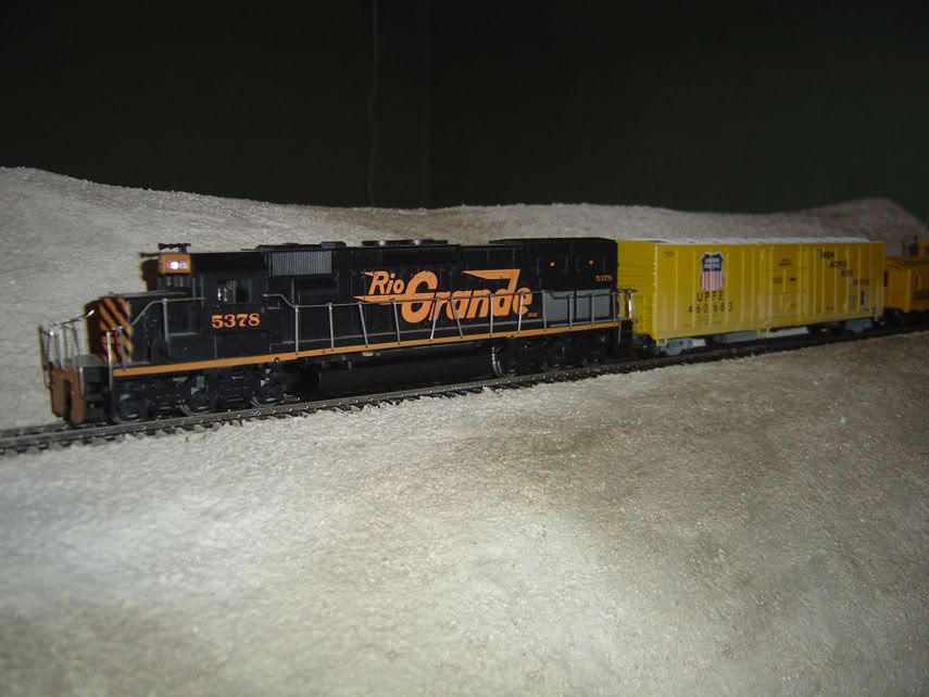

I just did my plaster today (Yipee!!) I used the Woodland Scenics risers and inclines for the track support. Then used the wadded up newspaper with paper towels dipped in plaster method. I tried using the Woodland Scenics plaster cloth but for the price it doesn’t go very far, I did a diorama and it took $10 worth of plaster cloth! I di use a lot of foam as support also (I had a couple old foam ice chest) they were a great size for a level spot to put my town.
I will probably have to go over a couple areas with plaster after the paper towel layer dries. I read about Joe Fugates method and it looked pretty good, not sure why I opted for just plaster. I guess the fact that a 25 lb bag cost $8 at Home Depot helped. I did a 9"x8" layout with one bag.
