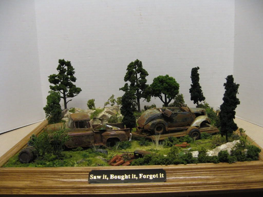

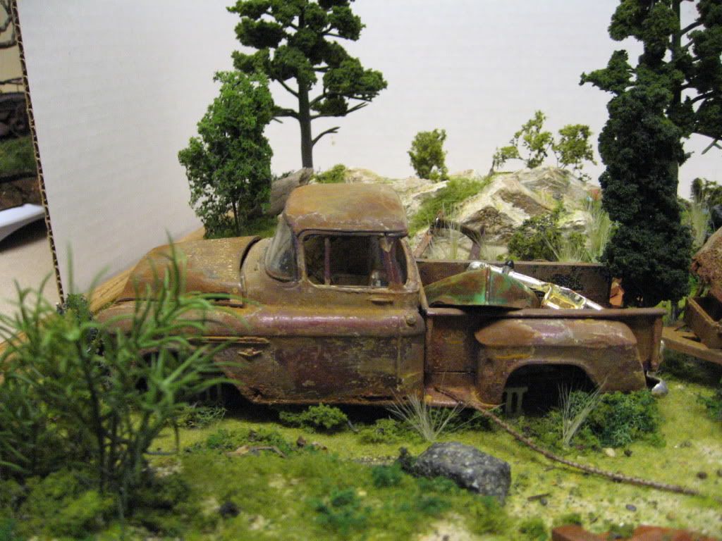

Hay, what can I say. I like the goofy ones too. here’s an example of some of my ground work.
I don’t know why the first photo printed 3 times, only put it in once. total of two pic. ???
This scene begs to be modeled (long-abandoned logging/lumber company trucks).
