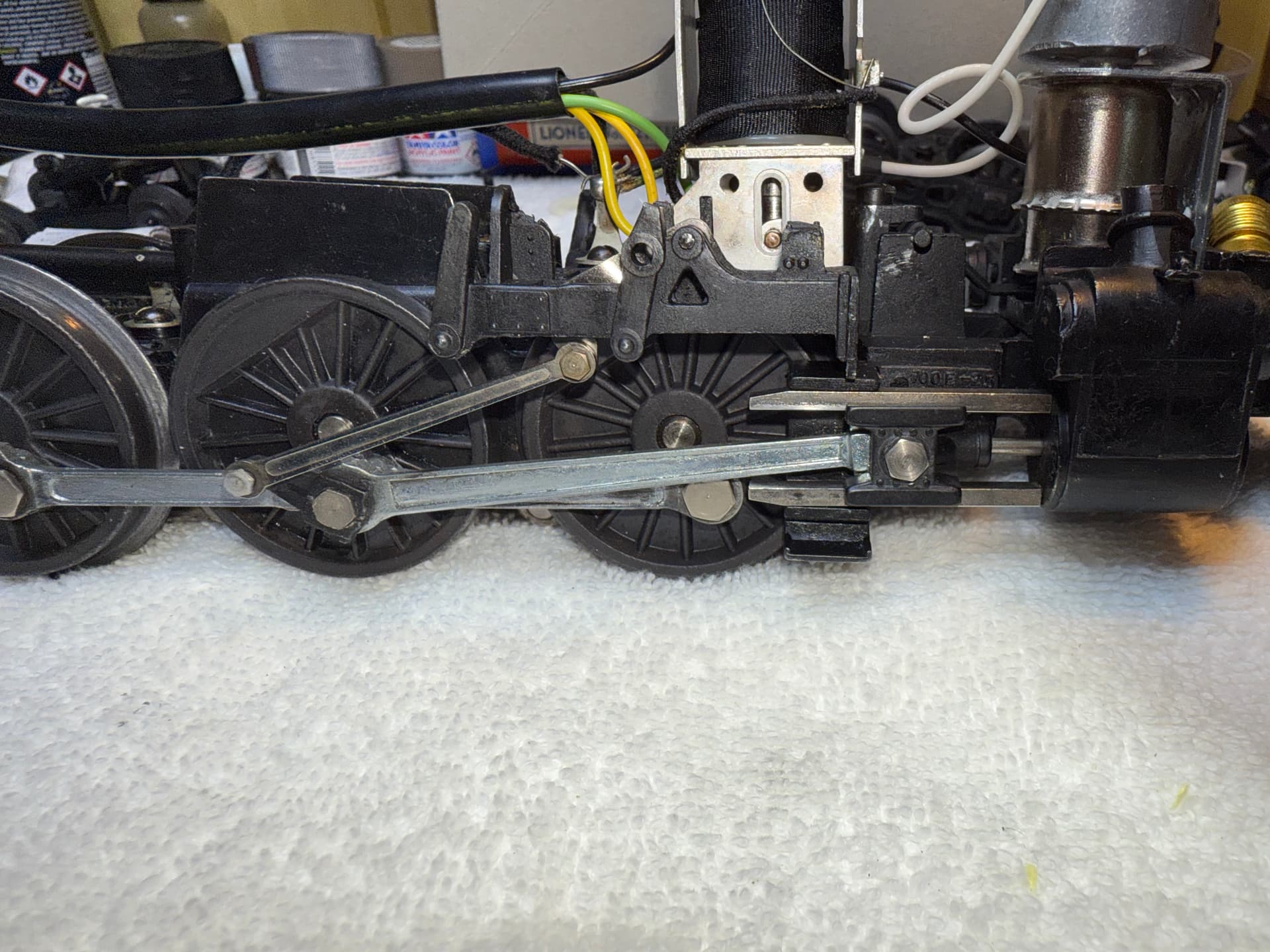

I recently purchased what is purported to be a nice Lionel “1964” 773 loco.
I am servicing it this week.
Not quite sure that this is a 1964. For the life of me I can’t discern between the ‘50 vs “64 valve gear.
Also, it was my understanding that Lionel added a third magnet for the worm cover. Mine just has two.
The rollers are correct for ‘64 super O, but those could have been changed out. Here’s a pic of my running gear. 773 numbers appear to be the smaller variety.

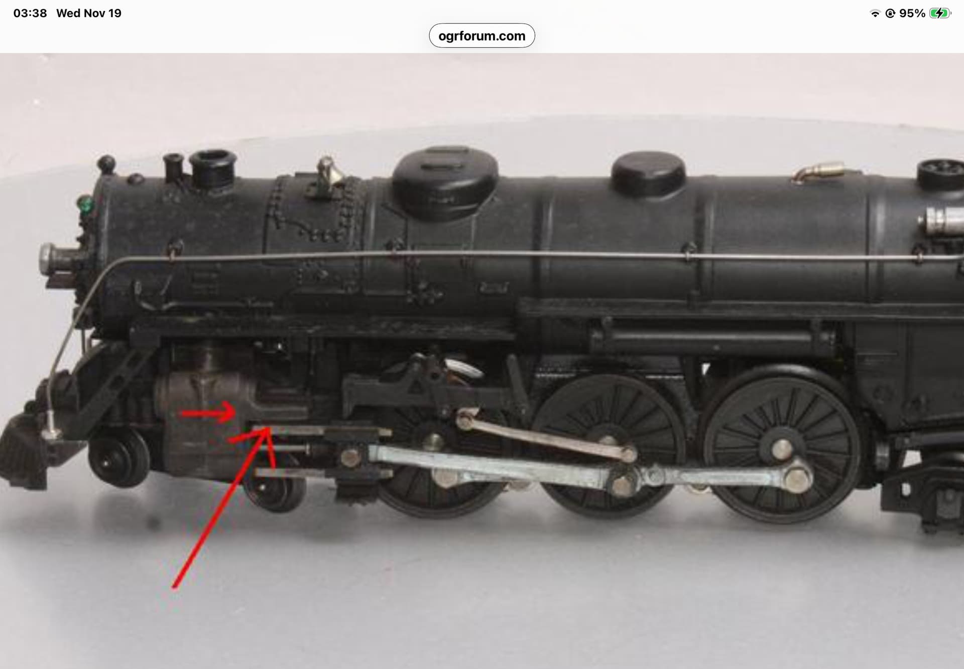

I finally found a pic with helpful arrows pointing to the “missing” valve guide in the 1964 issue.
It’s on the steamchest. So I guess I really do have a ‘64. The only having 2 magnets through me off.
