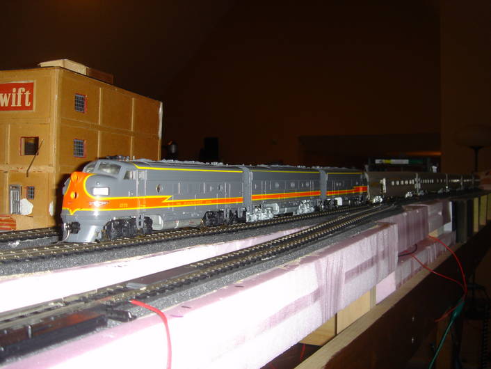

These are old. The lead F7 was built some time back in the Eisenhower administration.
The color scheme, I believe, is the Milwaukee freight pattern. It’s a very different color from the Milwaukee F7’s offered for sale today, which all seem to be the passenger colors.
This is a pair of GP-9’s. The one on the left is an old Athearn (Kennedy/Johnson timeframe) and the one on the right is a modern P2K.
The old Athearn geep was a rubber-band drive, and is now a dummy engine without a motor. Likewise, the trailing F7A and the F7B in the top picture are dummies. The lead F7 still has its original motor and drive train, plus a DH123 decoder. I cleaned up the motor and gears a bit after its 40-year slumber in the attic, added a LED headlight and Kadees, and I was able to get it to run. That was, however, my only success out of the 10 or so engines I tried to bring back to life.
