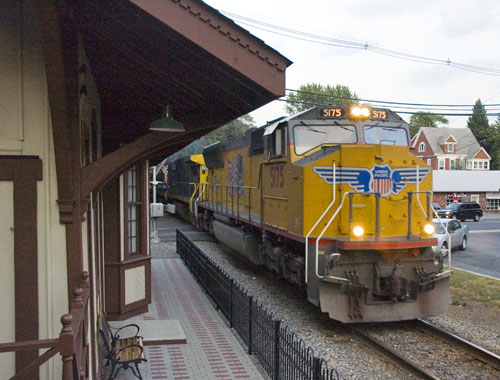

Looks like it sticks out pretty good on the real one:

I saw one for sale on ebay awhile agom and the fella who was selling it had removed the door and sanded it thinner on a flat sanding block. It looked way more prototypical that way.
Over the past year I have purchased 3 of this SD70M units from Athearn, but haven’t started working on them yet. Today I was checking out on of them and noticed that the nose door stuck way out. What is up with that? Is there a fix for it, or should I just except?
The Genesis SD70M’s nose door is way to thick. It can be shaved down very easy to match the correct thickness of the prototype.
I have several of these and some of the Overland models too. The door thickness was an eyesore with my Genesis models. If you remove the shell, you can pop the door off by pushing on the back side of the door. They are glued on and usually come off very easy.
Once it is off, you can lay it on a flat file and continue to work it back and forth until you have the correct thickness. I was able to do this with all of the units factory painted without causing any damage to the paint on the door front. It is about a fifteen minute job once you do one and the results are great. When you get the right thickness, glue it back on.
