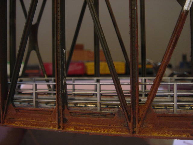

I’ve used a product called Instant Rust. I got it at Michaels arts and crafts store.
This is done on a styrene kit, Atlas’s chord bridge model. I’ve also used it on metal and on plastic rolling stock. Instant Rust is a 2-part application. First, you paint on the “Instant Iron” which is a suspension of very fine iron particles in some kind of liquid. After that dries, you paint on the rusting agent. After an hour or so it’s all rusted out. It looks like rust because it is rust.
Instant rust seems to look the best. I can’t seem to find the stuff though.
I’ve got the GC Laser rust stuff and it works really good. It’s just a one part liquid you paint on and let dry. You can do several coats for more rust. Smells like a vinager based product. I found adding a drop or two of alcohol into a small cup of it keeps it from beading up on the plastic. Lets it flow and streak better.
If you can find the Instant Rust, go with THAT.
