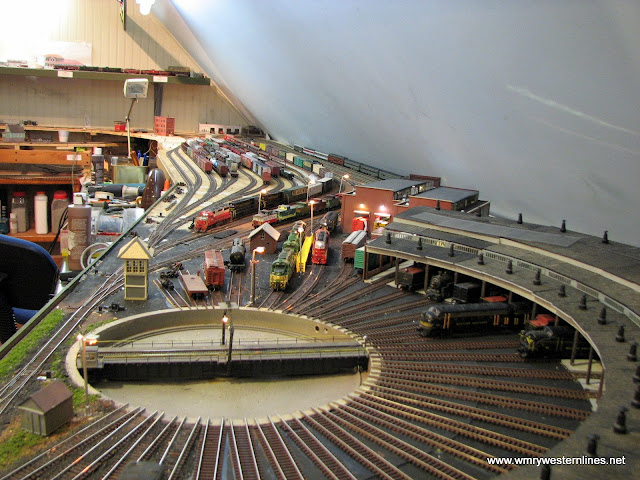

Mine’s double ended, and located between the engine house and the Arrival/Departure tracks. It’s easy to pluck the caboose from the tail of an arriving train and park it for servicing, and to pull a fresh one for the next train out. It’s long enough to hold about 8 cabooses.
Here’s a closer look.
Lee
