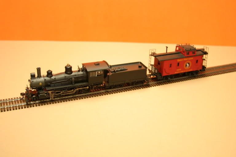

http://i23.photobucket.com/albums/b371/IronGoat/IMG_3347_A.jpg
http://i23.photobucket.com/albums/b371/IronGoat/MartiesPhotos161.jpg
The old IHC 4-4-0 is a great runner and puller but doesn’t have the detail the Bachmann does and mine was straight DC
Here it is next to the BAchmann
