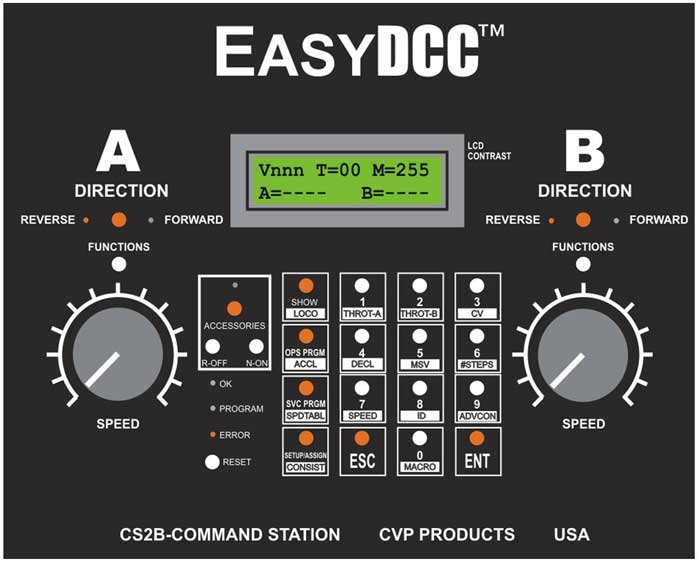

The CVP “Easy DCC” system I use has a Command Station with two built-in throttles to run two engines/trains separately. If I want, I can run things sitting down and throw all the mainline turnouts from there. When I’m done running trains, I like to set all the turnouts back to “normal”, so I do “accessory” “1” “normal”, “accessory” “2” normal, etc. until they’re all set, then hit the “escape” button to clear it. Goes very quickly!
Works the same with the handheld, but you have to hit “escape” between each turnout - but then, I normally am only using that when following a train around and doing one at a time (although it’s nice to know I can run trains and throw turnouts with the remote from anywhere in the basement).
