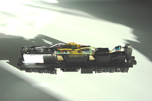

Sorry for the poor lighting, but I took the photo quickly. This is a P1K RSC2 with a Soundtraxx DSD-LL110LC decoder. This decoder is the ALCO version. Interesting enough, this decoder’s form factor is designed to fit P2K GP7, GP9, GP30 and SD60 locomotives; yet there it is an ALCO version of it.
The speaker I use produces 3dB more output than the Soundtraxx speaker; It is DigiKey Part Number GC0351M-ND; I use this speaker in Genesis F units and narrow hood diesels; properly baffled, it produces more output than similar round speaker offerings.
Notice the baffle below the speaker; it isolates the air of the front side of the cone from the backside. Air pressure is created in the baffle firing down through the truck opening as well as against the shell (infinite baffle); this effect is significant with the shell on. The infinite baffle lowers the resonance, producing a warmer sound. I soldered the wires directly to the pins on the decoder board.
I use LED’s for optimum effect; to do this with these DSD decoders, a RC circuit consisting of two 1K ohm resistors and a 0.1 microfarad capacitor is required to eliminate the “flicker” that is evident when the loco receives DCC commands or the “glow” when the opposite direction is selected. The LED’s are yellow-white versions from Miniatronics or NCE.
You can also use a small N scale or Z scale decoder combined with a Soundtraxx DSX decoder if you need more lighting functions (DSD has only FWD or REV) or you are looking for a Nathan M5 or Leslie 3 chime horn different from the Leslie horn types (single, three or five chime) that come with the DSD series of decoders.

Carl - thanks a lot for the info and photo. Did you have to cut out any weight to put the speaker in? I was thinking of installing the speaker in the cab, where there’s actually a bit of space.
Carl, I mean I don´t want to make a lot of cuts and such as into the model, as a modeller in a forum who puts a Soundtraxx with a lot of hours of working inside, cutting, sanding, etc. The Kato is as a precision piece, and don´t want to make mistakes. Thanks
The great thing about the Proto 1000 RS units is they have plenty of room inside. The weight is in the frame. I was able to create the styrene chamber in the open space without removing any existing material.
