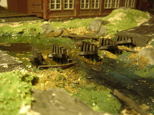

I used two-part epoxy resin. Probably similar to envirotex. Poured it in three different coloured layers.
Mike
I like your results very much, Mike. What did you use to colour your “water”? I also used a two-part epoxy, but the instructions caution about mixing any water in with it, so I felt that water-based paints were out.
-Crandell
Crandell - funny you should ask that [:D] I thoroughly read the manufacturer’s instructions and they stated their product can be coloured with acrylic paint, but test first. [which i did ages ago with some brownish puddles I made for my diorama]
I assumed that since acrylic paint is water-based that it would be possible to dilute it with water to help it flow. Wrong! Mixing it with water made a concoction that looks remarkably like ice. Actually “mixing” is the wrong word because they refused to mix.
Anyway - adding acrylic paint in moderation has done no harm at all. I can post more pics somewhere if you like.
Mike

I also used acrylics to mix with my Envirotex. I used about a drop of paint (which doesn’t actually drip, so you have to imagine it) in a mix of 1 ounce of each of the 2 components. In this first-pour shot, I used a bit of blue and a bit of black to get a dark, cloudy look for the bottom of the stream, which was also done with blue and black on the stream bed:
My subsequent pours were more green and brown, and not as dark. What this does is get rid of the “clear as glass” look that so many layout ponds have. I was looking at a number of water models over the past couple of weeks at a show and on a layout tour, and most of them were just clear pours. As Mike pointed out over on Trainboard, the water looks much more realistic if the color comes from the water itself, rather than just from the painted streambed.
Here’s a later photo of the finished stream:
When you look into a real pond, the image gets fuzzier and fuzzier as the water gets deeper. By adding a bit of paint, you cloud the water and reduce its opacity just a bit, which really improves the illusion of depth.
