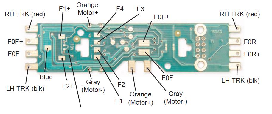

Which 165 decoder are you using, a DH165A0 ? Is everything else working (i.e. motor control, sound etc…) ? Did you change any CVs other than the address when you programmed it ? Here’s a picture of a DH165A0.
DH165A0
If things still don’t work, try connecting one of your bulbs/LEDs directly to the FOF connectors, hitting F0 when the locomotive is in the forward direction. Try flipping the leads if that doesn’t work and let us know how you progress…
