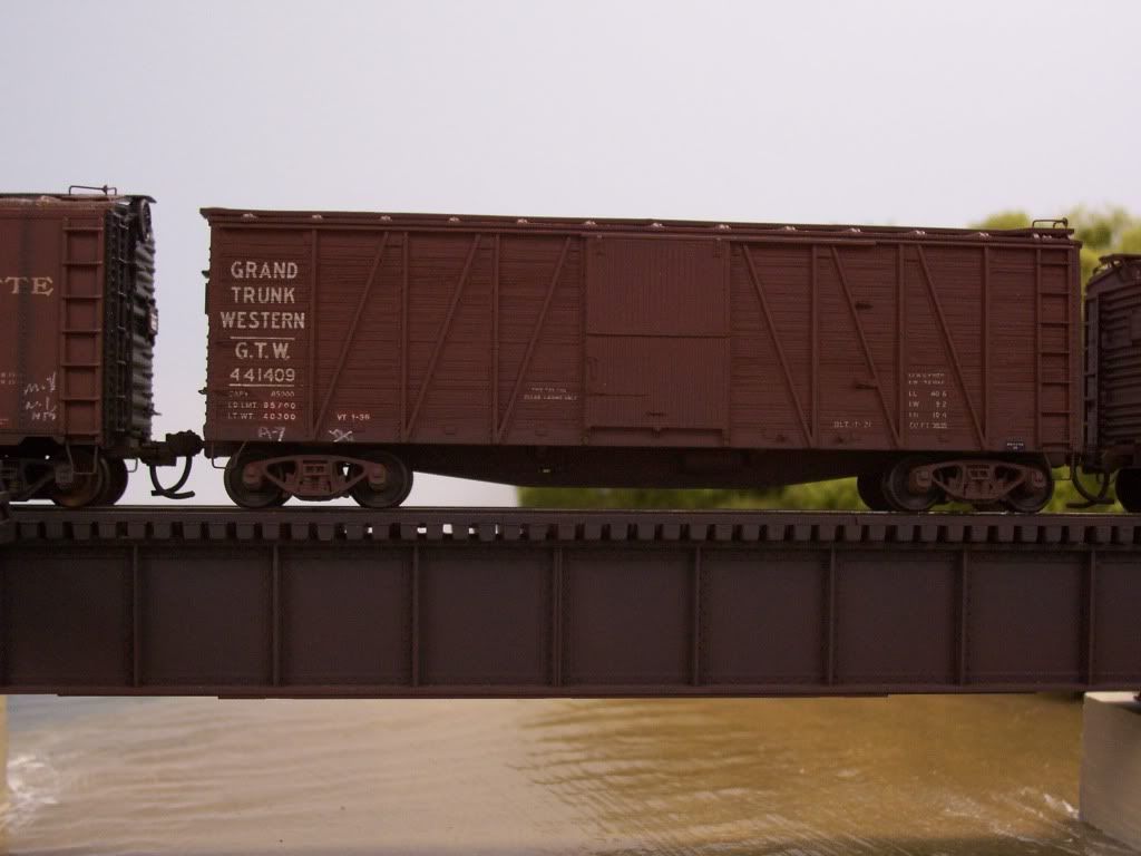

With Kadee #5s (and all of their others with the same size head), I seldom worry too much about coupler height as long as that ugly “air hose” is adjusted so that it doesn’t catch on grade crossings or turnouts. The scale couplers, however, are less forgiving and quickly point out the older cars with improper coupler heights.
Most of th
I have some prototype photos showing coupler heights which vary almost as much as in Wayne’s model photo.
Wayne and others might remember when guys started to twist the Kadee “air hose” backwards so it would be less visible (maybe I really mean, less annoying), yet still do its job over a magnet. It didn’t work equally well on all cars.
