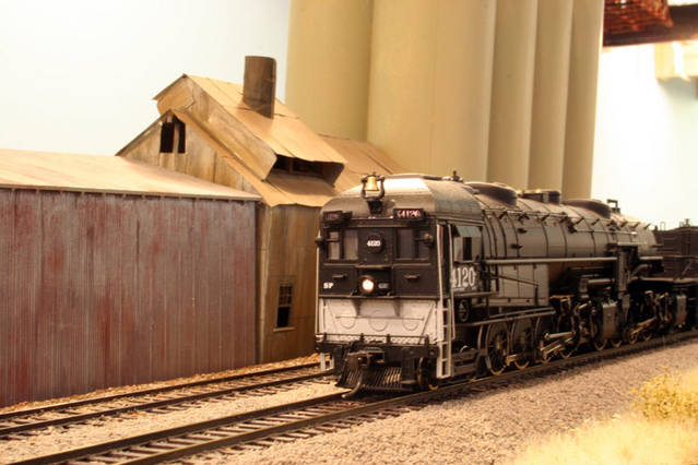

ME has finer railhead profile and spike detail than the other brands and the price reflects this difference. I use ME exclusively for visible flex track. I take lots of close up photos and the details do show up in the pics.
ME codes 70 and 55 un-ballasted.
ME codes 80 and 70 ballasted and painted.
Before I made my decision, I ballasted and painted a stick of each of the major brands available and compared them. ME looked the best to me in the side by side. While it is true that all of the brands look good when painted and ballasted, to me ME looks a lot better than the others. If it is important to you, I would buy a stick of each of the brands and compare before making a large purchase…
