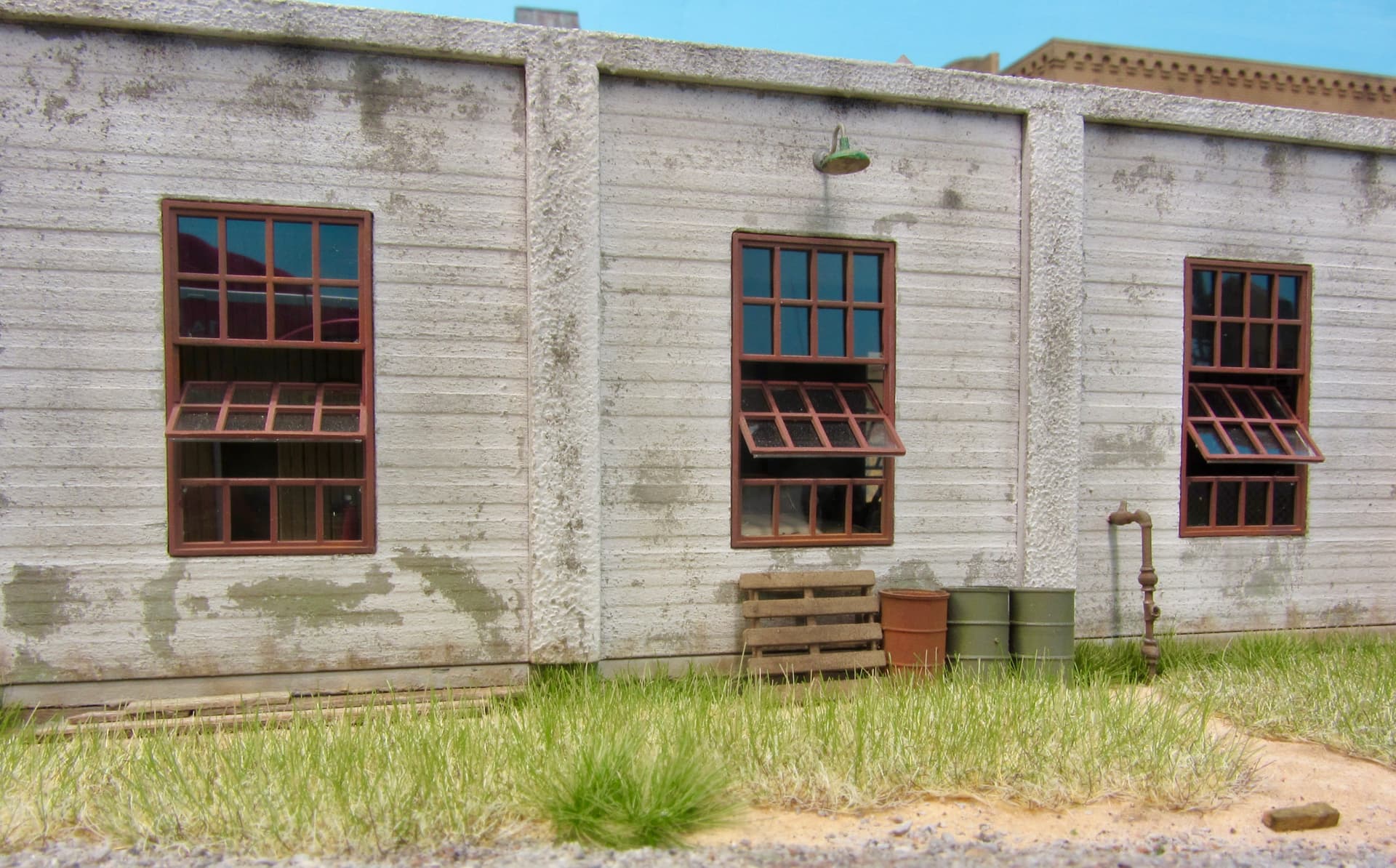

…but plenty of zap to do the job. I bought three more zappers, at about $6/ea on closeout, just to keep on hand.
IMG_8053 by Edmund, on Flickr
I wouldn’t add any salt to your glue mix. The spark from mine will jump if I hold the screen within a half-inch of my ground pin. Sometimes I get too close and jump ten feet when I accidentally hit the pin. Grass flying all over.
IMG_7107 by Edmund, on Flickr
This is just a preliminary cover. I’ll go back and add more weeds and brush later.
IMG_8058_fix by Edmund, on Flickr
Does the spark jump to the screen when you quickly touch it? Batteries? A good grounding pin?
Good Luck, Ed
