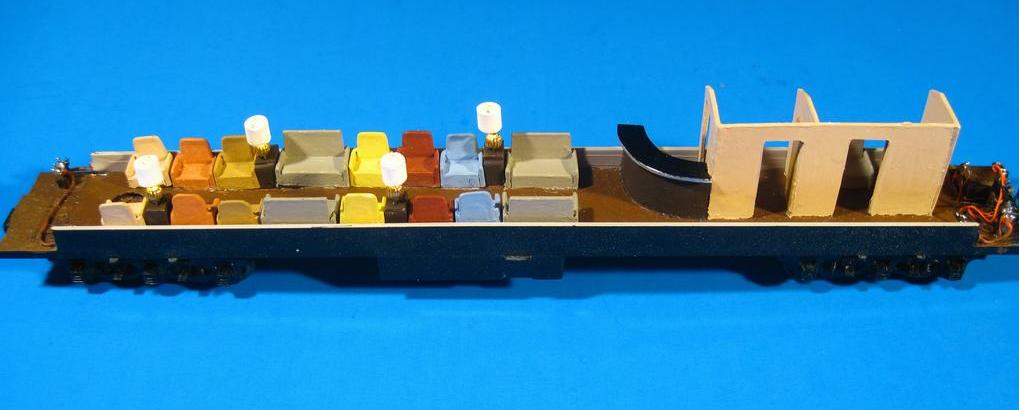

I’m not into brass because I have a small layout with a 24” and two 26” radius curves so I stick with the Athearn 72’ passenger cars. I use the Athearn window glass.
For interiors I build up my own. There are some very nice interiors available on ShapeWays but can get pricy.
I normally search the internet for passenger car footprints then construct my own to fit the 72’ shortys.
I picked up several interiors over the years and chopped them up and made molds and then cast the parts from resin.
The floor and walls are .03” thick Styrene sheet.
I make the table and floor lamps from Styrene tubing and 3mm LEDs with beads for bases.
The passengers are Mel resin castings.

Mel… you’re good! [bow]
