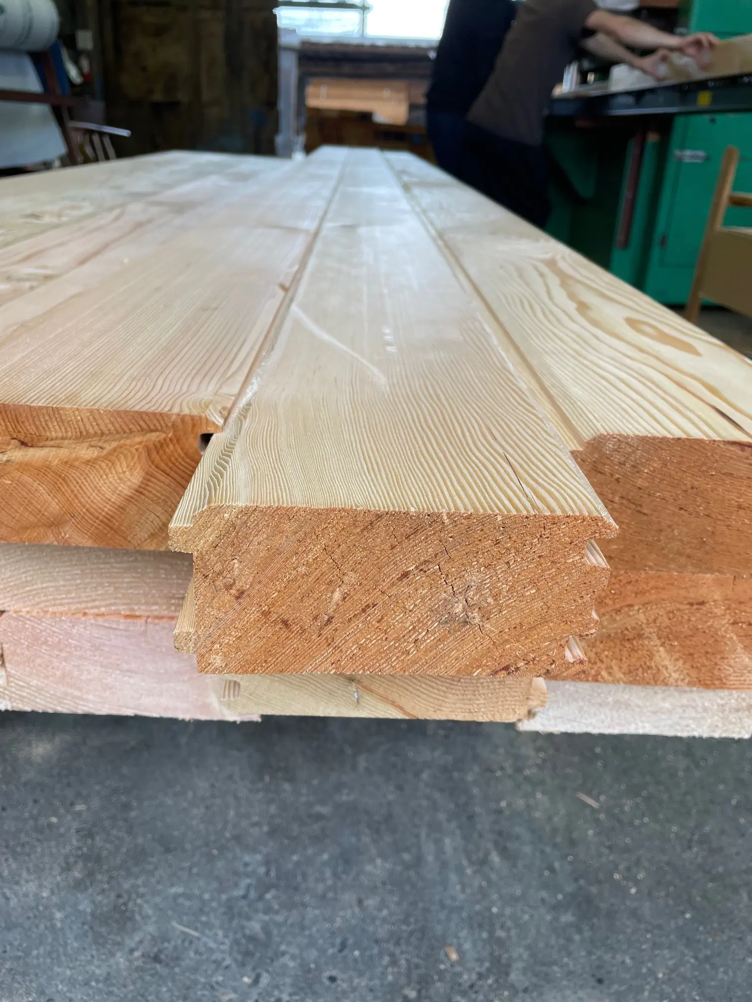

This company sells 3" X 6" X 10 foot planks for railcar decks:

So you think that flatcars might be decked with 1/32 birch plywood instead of 3x6 double-tongue-and-groove?
