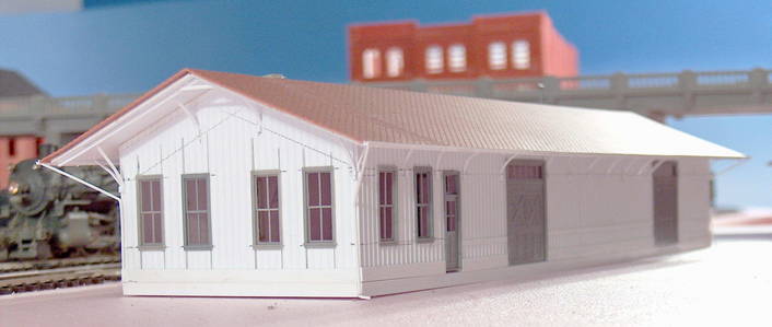

An HO Atlas trackside shanty
I find it represents wood better than wood because there is more control over texture and color.

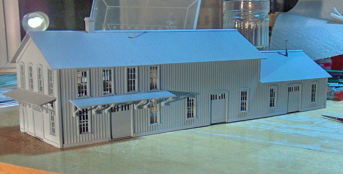

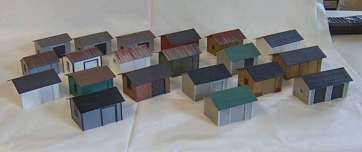

I suppose that there might be a use for wood in model building that makes it better than styrene, but besides natural wood color, I haven’t been able to figure out what that use is. Plastic does a LOT, and does it better than plastic: cutting, gluing, speed of assembling, finishing, etc. I’ve built stuff out of wood before (I’m working on several AMB cabooses now, in fact), but if I had to scratchbuild using wood, I wouldn’t bother. (for example, all the stuff shown above was done between Thanksgiving and Christmas. With wood, I’d STILL be working on it!)
