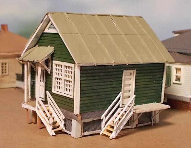

I built my first laser-cut kit, American Model Builders N scale #622 “Dill’s Market.” However I modified it a bit and scratchbuilt some details to make it resemble a Galveston “alley house.” It is supposed to
The awning provided in the original kit to go across the entire front was cut back to cover only the front door. Because Galveston is subject to hurricane flooding, many buildings are raised above ground level, so I put this on concrete piers representing pier and beam construction.
Framed lattice (made from brass screen mesh and framed in place) between the piers were intended to keep rats and possums from making a home under the house. My screens were not all straight and neat, but that happens on the prototype…
The height of the building floor level above the ground required stairs and landings.
A grain-of-rice bulb is embedded in the wall to the right of the front door to represent a porch light, and at the let of the door, I used a chunk of styrene rod to represent a mailbox and a sliver of thin styrene sheet for the mailbox lid.
It has been almost 3 months since I have had anything on Weekend Photo Fun and I wanted to get this up although it still needs some railing on the side porch. Some flower pots and other tuff might be in order. I need a “classic” corrugated garbage can—need several for a 1950s alley scene. And I have not yet added an electric meter box, fuse box and gas meter I am building for the back side of the building.
Not installed on layout- just set with some other structures on a makeshift diorama- wanted to get something up in WPF.
This model is not intended as a specific prototype house, but as a typical style found in Galveston

Robby: Nice Weathering on the boxcar. ----- Rick:.U25B looking grat so far. Looking forward to seeing the complete model. ------ Curt: .Wood reefers look great! … ----- Leighant … I like your alley house! ----- Mar_Magnus: … I like the building!
