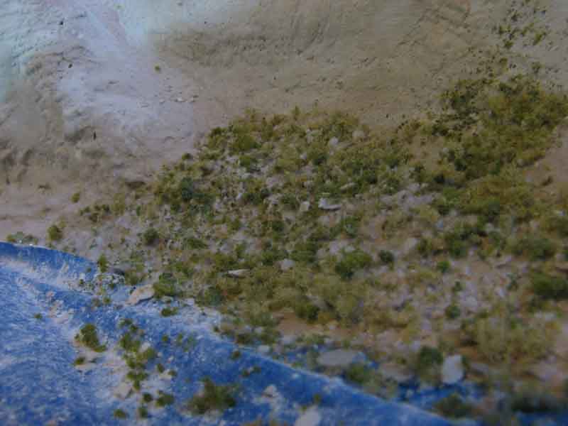

I’m in the process of building the Subterrain Scenery Kit as an introduction to the WS Subterrain Foam system. I’m at the point where I need to cover the newspaper rolls with plaster cloth. Following their directions, and “covering as many holes as possible,” still leaves plenty of holes (the soggy newspaper underneath didn’t help to provide a good support to fill the holes). Is it normal to use more than one layer of plaster cloth (after the initial layer has completely dried) to achieve satisfactory result?

Looking at your photo, it appears that the cloth might have been dipped a bit too long. One needs only dip the cloth in the water very lightly and really no more than a second (from the first dream plan build video). Otherwise, it becomes runny and plaster runs off, leaving less material on the cloth. Another option is to spray after laying the cloth on the surface, although this works better for shallower slopes. This would cause less loss and fewer holes.

I agree with Art on this one. I use Gypsolite as my final coat before painting in most places. It is plenty to cover over the holes in the plaster cloth. Even if you don’t want to use this, though, I think that the holes will not be a problem after you paint and turf the area.
Give it a try. Pick a small area, paint it some yucky color of green (I use “foliage”) and then add glue and turf. If you like the result, fine. If not, get some Gypsolite or mix up some ground goop and bury your mistake, just like the doctors do.

Sometimes I use more than one layer–only when I need more strength. Overall, I just usually make sure I go back and forth with my finger to cover as many of those small holes as possible–using the plaster in the cloth. Then I paint a base coat of brown (my setting is central/eastern KY) and apply ground cover.

For my Gypsolite surfaces, I mix in some brown acrylic paint before I apply it. The Gypsolite is naturally a very light gray, and the paint turns it to a light tan. However, I believe in “irregularity” of the surface, so after the Gypsolite hardens, I go over parts of it with a thin green wash, ending up with a “camouflage” pattern. Sometimes I use a darker gray on parts, too. Then, when I turf the surface with 2 or 3 different shades of turf, I completely avoid the “golf course” look and instead get something wild and wooley.
