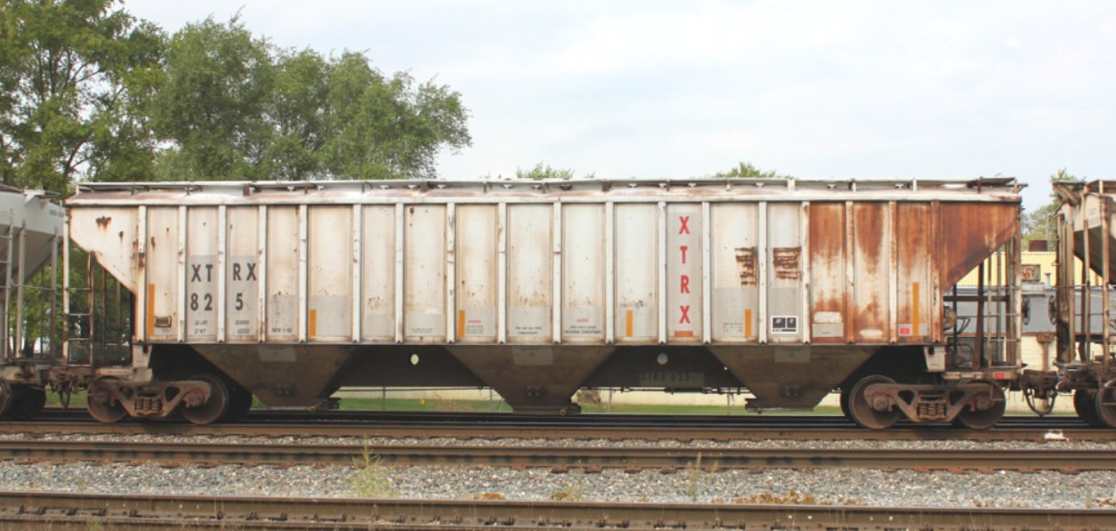

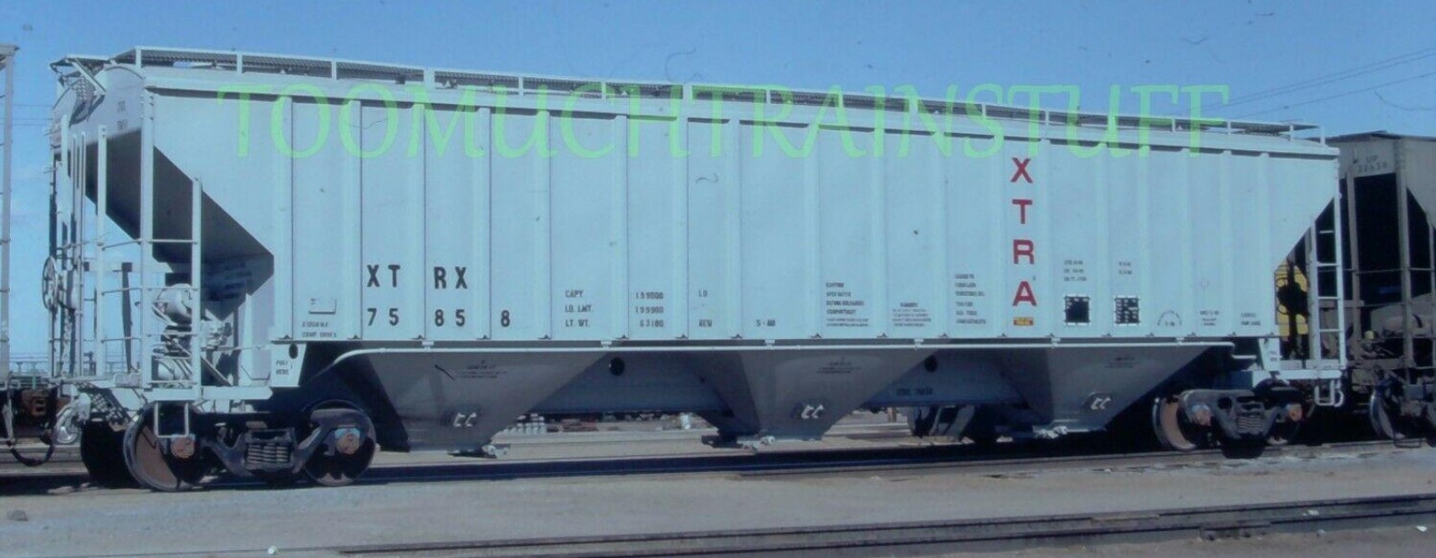

Well now this is interesting. Take a close look at these two pictures.

Both cars have the XTRX reporting marks above the number. That tells me that XTRX is the official reporting mark. The XTRA appears to be a branding.
Yes! The official reporting marks are the 2-4 letters on the left side of a car, and the numbers below it. The XTRA on the blue car isn’t a reporting mark, it’s XTRX 7585.

The other car is marked XTRX where the ā€œblueā€ car is XTRA in the same red color. Why would that be?
Not sure, except it’s something the private company chose, perhaps to keep track of what the car is used for. I notice one car has a three-digit number and one has five-digit number. Perhaps one series of cars is used in say grain service, and the other cars are used to haul some non-food product. (You don’t normally use a car for cement and then turn around and put soybeans in it.)
