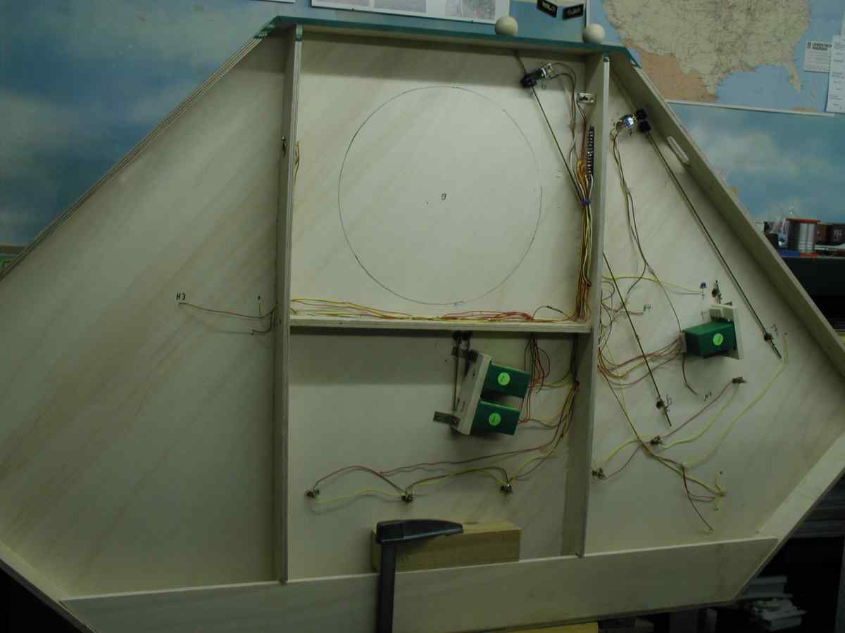

A corner segment from the new yard at Westport:
It’s easy and comfortable to work “under” the layout.
Wolfgang
