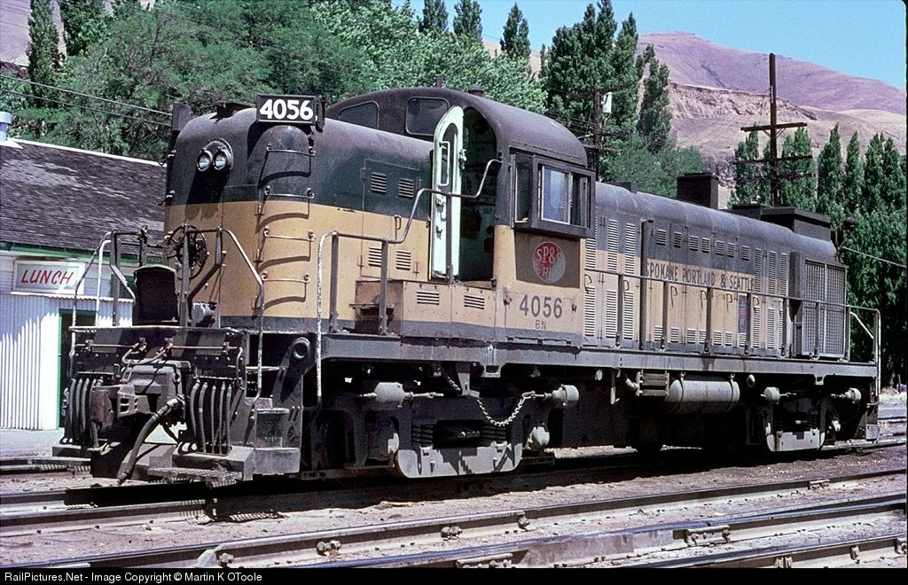

Looks like my livery is going to be ex Spokane Portland and Seattle.
I am going to look closely at these units.
The RS3 unit running on my layout will be renumbered and renamed for my freelance branch with the same scheme.
